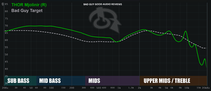

Original Thor Frequency response
That graph is not too shabby at all imo, speaking as someone who likes phat mids
Mjolinir…I got ya bro
