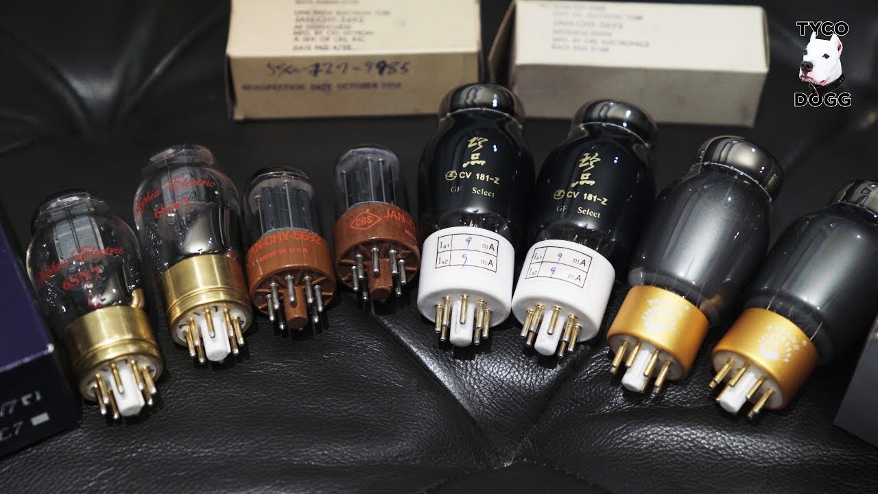

Anyone have any opinions or have heard these? Thinking about one of these for the Darkvoice.
Good tubes if you want something clean and neutral imo, although I’ve never tried one in a darkvoice
I want one of these, heard a demo of these (clear version) on a YouTube vid… See if I can find the link for ya…
These are nice for the monies…
