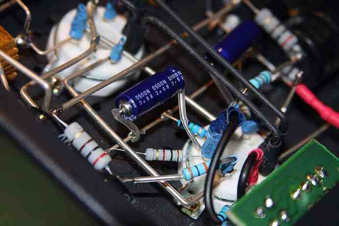

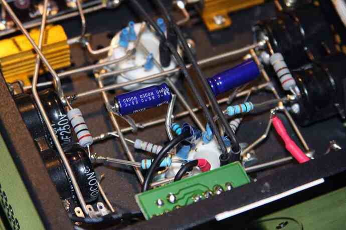

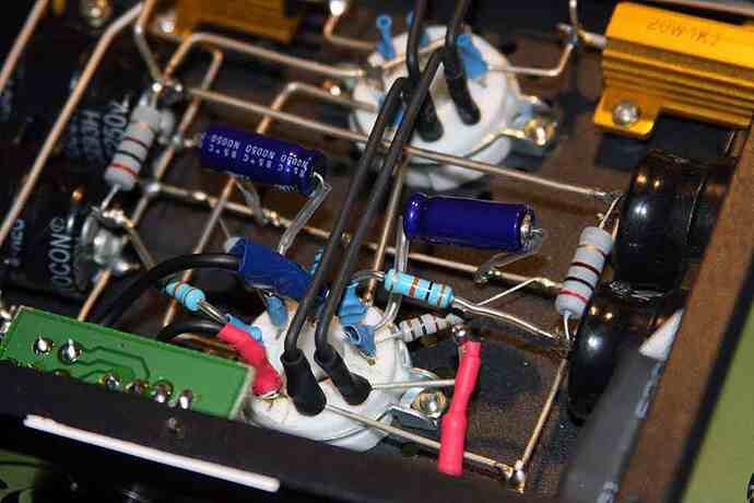

If you are interested in modding, the fitz mod solves the hum problem. It is relatively simple if you are handy with a soldering iron.
You will need 2pcs Nichicon VX Axial Capacitors - 16v 220uF 8x16 2pcs Nichicon VX Axial Capacitors - 16v 220uF 8x16: Amazon.com: Industrial & Scientific
You are connecting the 4 and 8 o’clock pins from the 6SN7 driver socket to the central rail. That’s it!
Those pictures aren’t mine, but they are what I referenced from the head-fi fitz mod thread.

Well it doesn’t have to be that specific capacitance, depends if you want more gain I guess, you can use 100uF to the same effect but get a bit less gain. Depends on what you want. Oh also If you want a higher quality capacitor there, I recommend an ELNA Silmic II capacitor:
100uF @ 16V:
220uF @ 16V:

A couple of head-fi’ers said minimum 80, so 100 would work. But I just was sharing my own experience as it is the only thing that I can confirm 100%. Sold my darkvoice for a decent profit recently thanks to the fitz mod. Now I just need to figure out what I want to upgrade to.
