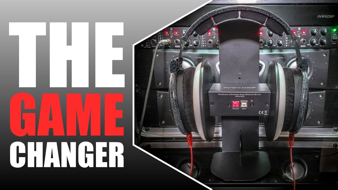

Also, here’s an advertisement for the EARS if you’re interested -
He doesn’t address the ‘accuracy’ issue, but I love Hexibase. Very knowledgeable, knows what he’s doing, and makes good content.

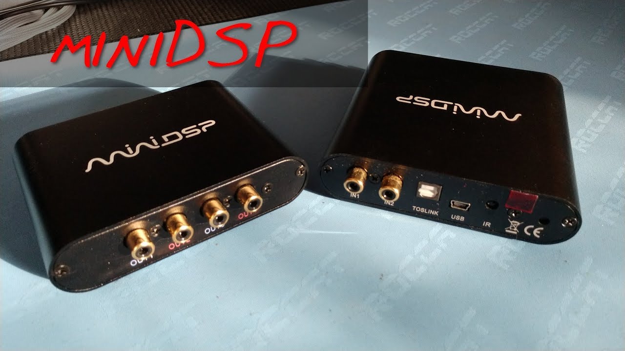

Thanks! had previously seen both those vids. It’s very comforting to know there actually is an n-channel PEQ option available for Macs. One project I already have slated for the end of shirt-sleeve-outdoors weather is to get the hang of PEQ a la EQ APO. After that, Mini-DSP may well look like a necessity.
