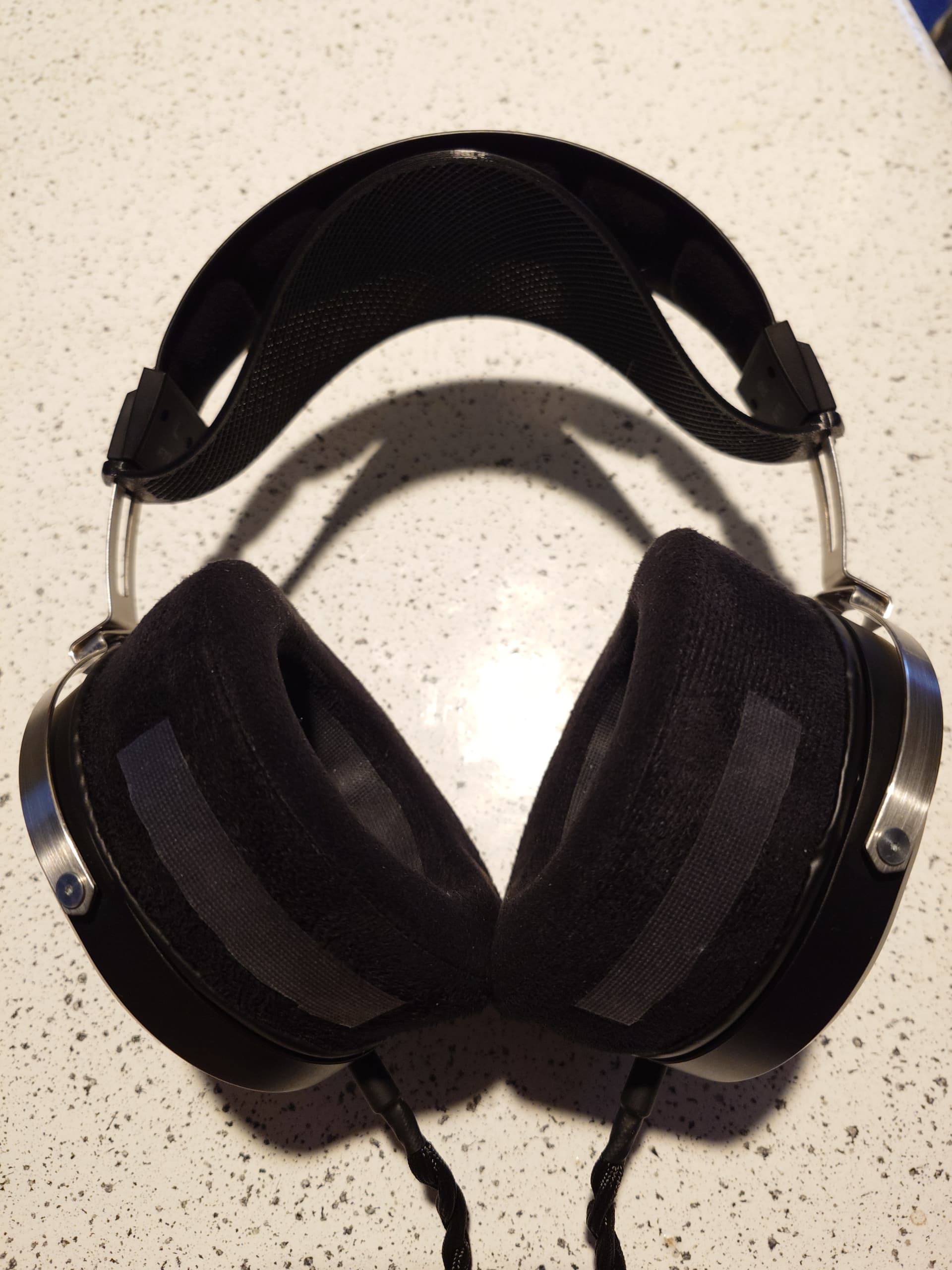

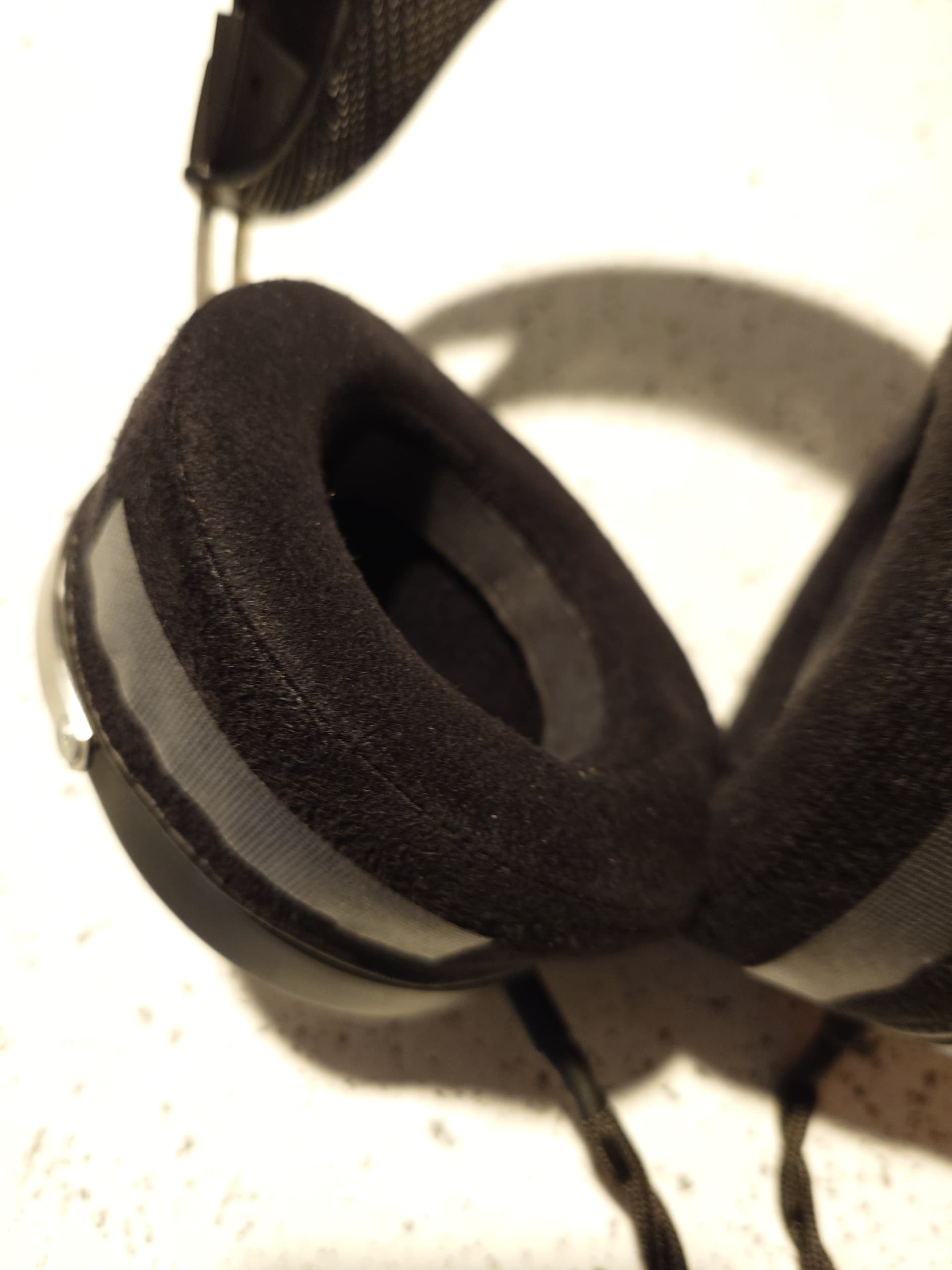

I took some 3M transpore perforated medical tape left over from my T50 modding days, cut the width of a 13.5” piece of tape in half, and wrapped one half all around the outside of each pad from the cup lip to half way up the pad wall. This provides a nice hybrid between the Brainwavz and the Eris pads.
Adding the tape helps bring back the 1 or 2dB of bass/sub-bass I was missing from the Brainwavz, while keeping the mid/mid-bass at their more tamed levels. The perceived increase in treble was also less.
Overall, the modded Eris pads provide a much more balanced sound a touch warmer than neutral, while still providing great instrument separation and timbre.

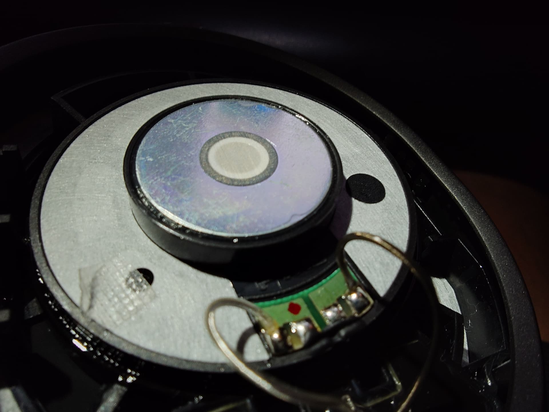

I removed the cups today and covered one of the driver vent holes as mentioned in the post, and I am very happy with the increase in bass across the board. Mids and highs still sound great, and there is a slight increase in airiness and soundstage.

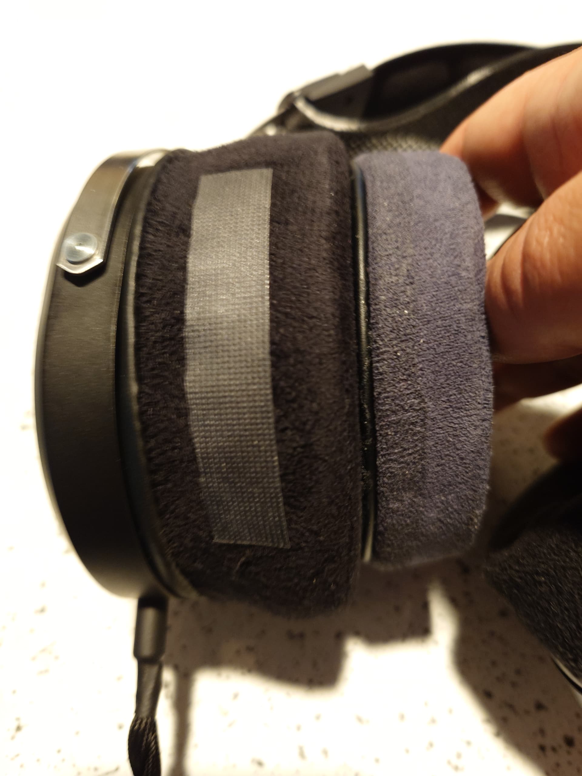

I guess I lasted longer than I thought I would, but I finally broke down and bought the Mod House Xenon suede pads to try out. Now I am kicking myself for waiting as long as I did.
Compared to the Eris pads I was using, the Xenons bring back ALL of the bass/mid-bass I found lacking in the Eris pads, and then some. There was so much bass/mid-bass that it was a bit overpowering and covering up instruments in congested mixes. The Xenons also had about 2-3dB of overall gain over the Eris pads that I needed to compensate for. Given the huge increase in size, the Xenons are super comfortable and fit my huge ears perfectly. The soundstage is also increased a bit, but not as much as I thought it would be.
I went back and listened to the stock pads and that notorious mid/upper mid-bass hump I have written about previously was thoroughly on display. However, I was surprised by the amount of bass/lower mid-bass the stock pads had that I had forgotten about. If that mid hump was gone I think the stock and Xenon pads would be very close overall.
I was able to tune the bass/mid-bass on the Xenon pads with some tape and 8-10 hours of OCD tape placement trial and error. I tried different size pieces of tape in a huge variety of orientations (small changes made surprising differences) until I finally came up with something that brought those instruments back in congested mixes while maintaining a great balance across all frequencies.
If you have pads that are close, but not quite there for what you are hoping for, tape is cheap and easy to try. You might be surprised by the results.

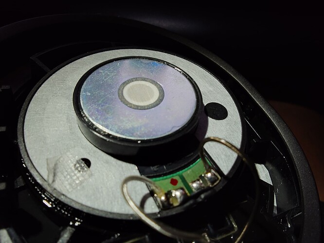

I am still using the Mod House Xenon Suedes (exceptional comfort) and was trying a ton of different pad tape placement mods with my open-back FT1’s, however it dawned on me that I had forgotten about the vent holes in the driver paper. When I originally open-backed them I took one of the sticky black dot screw covers and fully covered one of the vent holes (the Xenon’s are extremely bassy with both holes open).
I removed all of the tape from my pads and tried various hole coverage on the other vent hole. They sound amazing with just that small change.
I would imagine you can tune almost any pad to what you like using this. Just remember that very small changes do make a big difference.
