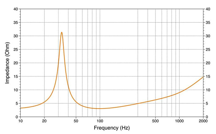

You would need a plot of frequency vs impedance of the transformers.
Like so (this is for a speaker, evident by the rise in impedance with rising frequency):
Two ways to do this (and both are difficult depending on your knowledge of electronics):
Buy an LCR-meter (20Hz to 20kHz range, expensive!)
buy a Function Generator, precision resistor (lower than 1 ohm, better than 1%, not wirewound) and a trueRMS (= TRMS) multimeter. Feeding frequency through the transformer, you then measure voltage drop accross the resistor for each frequency and type that into a spreadsheet. Then apply Ohm’s law and plot the result (cheaper than solution 1, loads of work)
