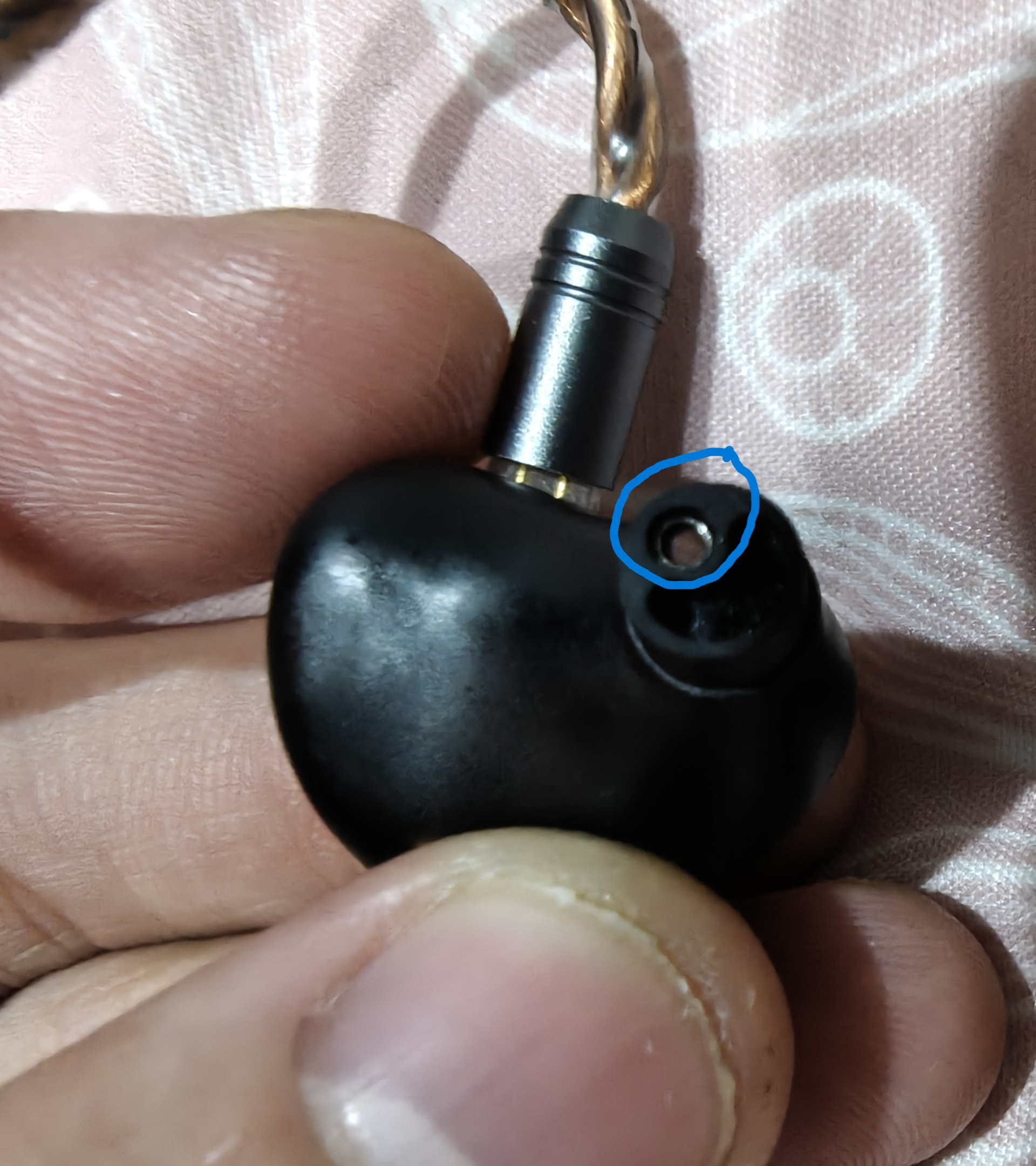

People that have more knowledge and more experienced than me in this hobby, I need your help. Right now I am experiencing something a bit weird on my Yu9 Que, and that would be that every time I insert the left piece in my ears, I experience a bit of a suction feel and it wasn’t there back then. As for the right piece, it does not have it at all and I always keep my IEMs clean before and after every use and I don’t know what to do.
Is this the reason why? It might be the filters or something for it seems to be one of the possible reasons why I experience that slight suction feel on the left side, and that happened to me with my Tanchjim Bunny as well, for I have replaced the filters of it and the suction feel is gone. I am not sure what filters should I replace it with and hell, I even keep this set dry with a dry box with a lot of silica gel inside. Any help and suggestions would be appreciated guys.
The Knowles damper in your pic seems a bit dull and darker brown vs other pictures online. My guess is that it belongs to the BA part of the drivers. I don’t know Que and it’s inner workings, but normally that bore won’t be part of any ventilation system on the monitor. Hopefully someone with these can indicate how well theirs seal and what feeling they give in ears.
Is the damper the same on both sides? Could be dirt/wax getting stuck on it and not just moisture.
As for why it can happen on one side but not both, it could be because our ears are not identical.

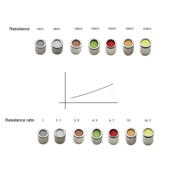

Knowles damper chart
If you want to replace the brown filter the closest would be the white 680ohm one.
If that is actually the knowles version then here.

Thanks man really appreciate it. And by replacing it how do I do it? I know it’s gonna involve a tool like the tweezers for it but I am not sure if I am gonna remove the whole tube with the filters on or just remove the filter from the tube? I am kinda intimidated on doing it to my Ques since I bought this set last year before New Year and it was really expensive.
You may want to get this tool.
https://www.aliexpress.com/item/32697221111.html
If that damper is just sitting there it should work.
You pull out the damper Ā«housingĀ» with the colored damping material inside. Make a note of how deep the damper is mounted. On other pictures online it looks like it’s the orange damper? I would change to the same color as you want the the same sound. The Ali tool is a bit more difficult to use vs for example this Custom Art tool:
A better tool makes the job easier, but it is for sure more expensive​:confused:
Edit: changed my mind on the damper color​:sweat_smile:. Not sure which it actually is​:thinking:
I think this seems to be the brown 1000ohm version. But otherwise the dampers are cheap enough that i would just buy one or a few pairs of each, it can be useful elsewhere. Depending on the lighting it may also look like the 3300ohm version…
Might as well give it a shot and if it does changes the sound on the left side, might as well do the same on the right side as well lol.
It WILL change the sound 100% IF they are different. Look at the other one and see if the color is the same.
Please note that the Yu9 Que has a damper installed in the opposite direction, first remove the fabric damper with a needle and then pull out the iron damper itself to avoid the fabric itself sinking into the channel.
