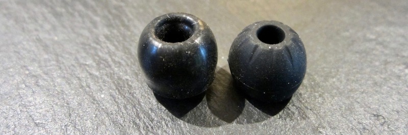

You could try this little mod with the included tips to see if you get a better seal:

I’d say the tips might be an issue. Lots of folks (including me) struggled with finding the right size when I got into IEMs. Too small leads to little to no bass. Too large, same deal and also less treble.
