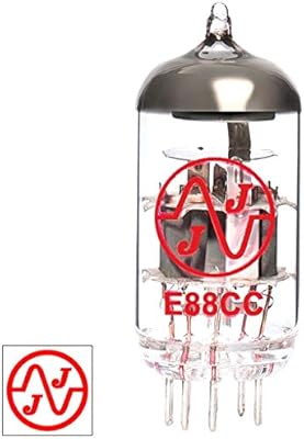

no doubt I will have more questions…but I have this JJ tube come up when I did a search for 6DJ8, but the listing only refers to 6922 / E88CC. how do those translate to 6DJ8?
Do 6922 / E88CC / ECC88 translate into referring to 6CG7 / 6FQ7 products too?
this listing also says it was made at a Tesla factory. does JJ always mean Tesla?

JJ was tesla, their new name is JJ after the eastern bloc fell.
I thought they were owned by the same conglomerate that owns all the old Russian Valve companies like Tesla, Sovtek and Silvana. But I could certainly be wrong about that.

okay. so then, how do these numbers,6922 / E88CC / ECC88, relate to CG7 and such?

No worries, different parts of the world use different identifiers for the same tube.
