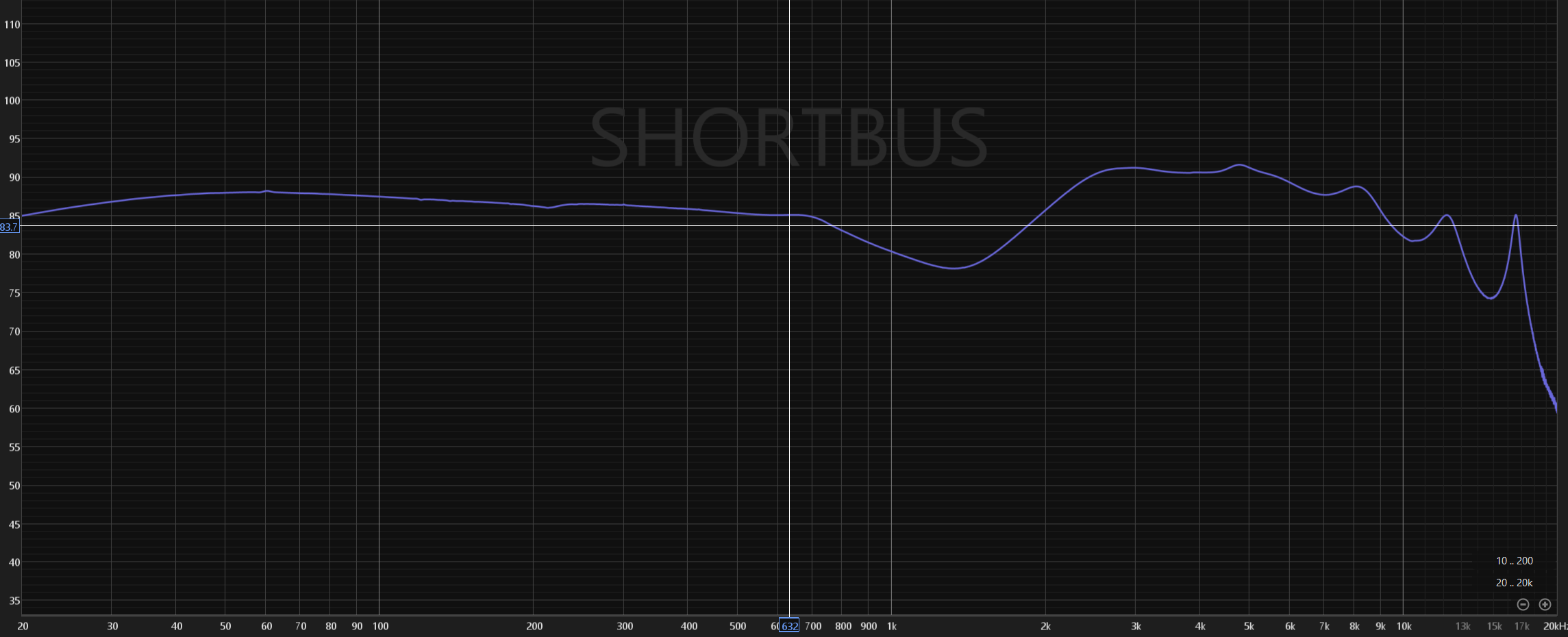

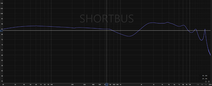

Nope, I have a brand new coupler and an older one and both measure exactly the same.. which is wrong.
Do you have another point of comparison besides pw? It would be worth to compare to 2 or 3 others besides him with the same iem.
Just by eye his seems like a bit of an outlier tbh.
Still being so far off in the pinna seems weird.
His is directly correct from looking at other graphs and indeed even their official graph. No, it’s definitely my rig somehow but I just don’t get it.
I assume you have checked that your rew settings are identical? Mic calibrated?
Maybe tried different on Linux instead of Windows to see if there is something funny with windows?
I’ve tried 2 computers, a clean load of REW. Haven’t tried linux because who has time for that. I may try an ipad next.. but GRRR, why could this be happening?!

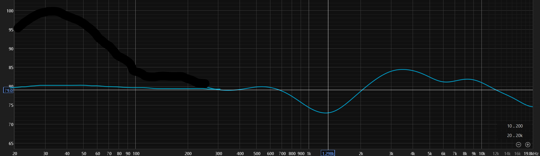

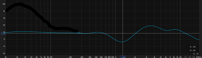

I’ve been on a tangent to find the ‘Shortbus meta’ tuning. This for me means something that actually sounds like speakers from about 8 feet back. I ended up just doing dumb stuff which is doing a free field measurement using the 711 placed right next to my ear, facing the same angle as my ear canal. This is clearly not an anechoic measurement as it is in my square room with reflections and room gain, etc. I ended up with this (smoothed) graph to remove as much oddness as possible and just get an idea of the general FR.
next I took my best anomaly tuning and used only 3 PEQ bands which I have available with my Motu MK5 interface to reform the tuning to about as close as I could get:
Upon listening, i’m pretty convinced this is much more accurate to the sound I am used to.
As far as I can tell, only the 64 audio Trio and Fourte do anything even close to this kind of tuning among thousands of IEMs. Very interesting! I don’t think I can tune 1 DD to be like this which is sad, but for future multi-driver iems, it is definitely on the table.

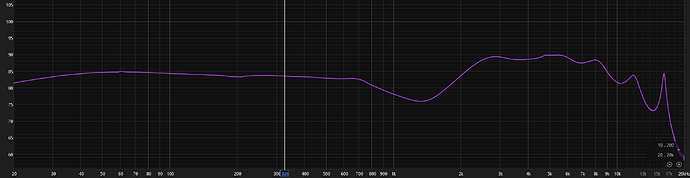

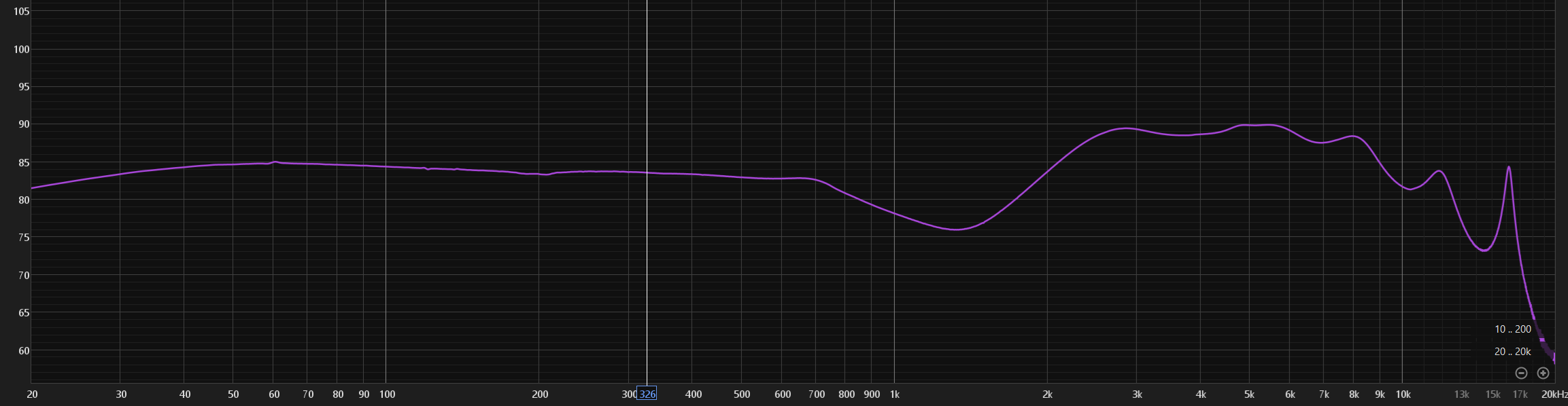

I messed around on and off today and achieved this:
Pants have been shat
Just watched the vid and I feel you should definitely try this with a multi-driver IEM in the future. IMO, the real innovation is to be found in trying new and exciting things like this and not pumping out endless permutations of the meta ‘du jour’ like some companies do.
