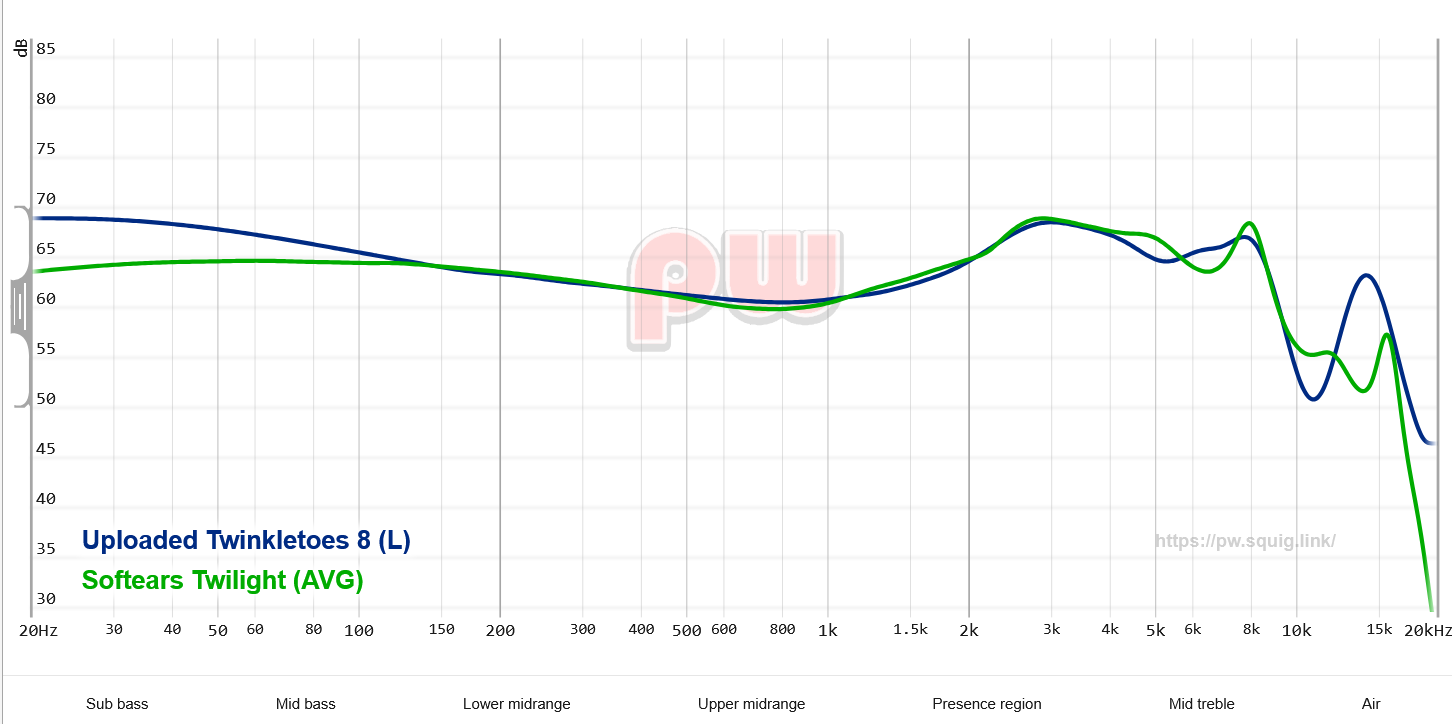

Maybe. I literally copied all parts that matter from one shell to the other so they have to sound the same barring fit. The twilight shell is incredibly minimal and non-intrusive BUT the custom shell locks in place much better and for that reason I find it nicer to run with and do activities in general.
You did say they lack in isolation, i think the custom shell could psychologically be a better fit.

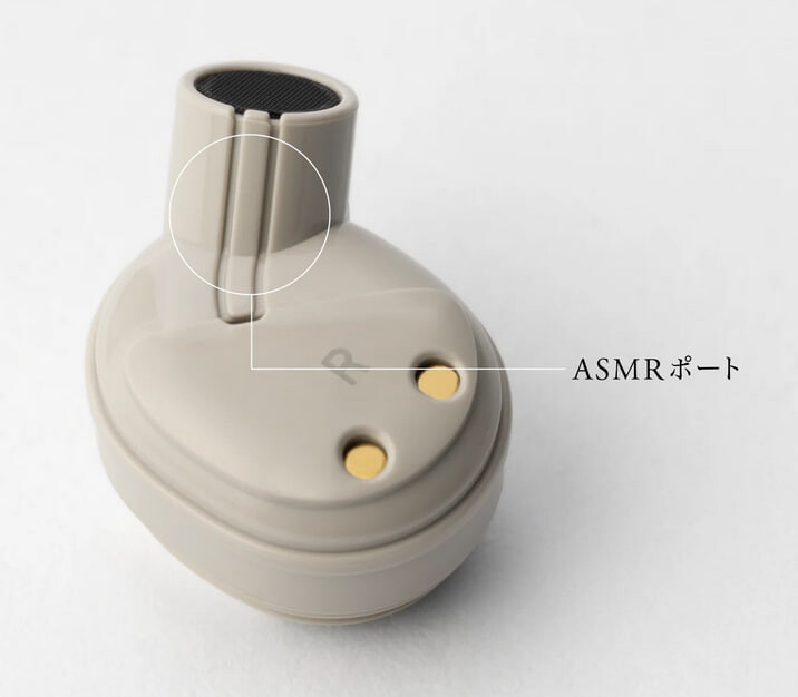

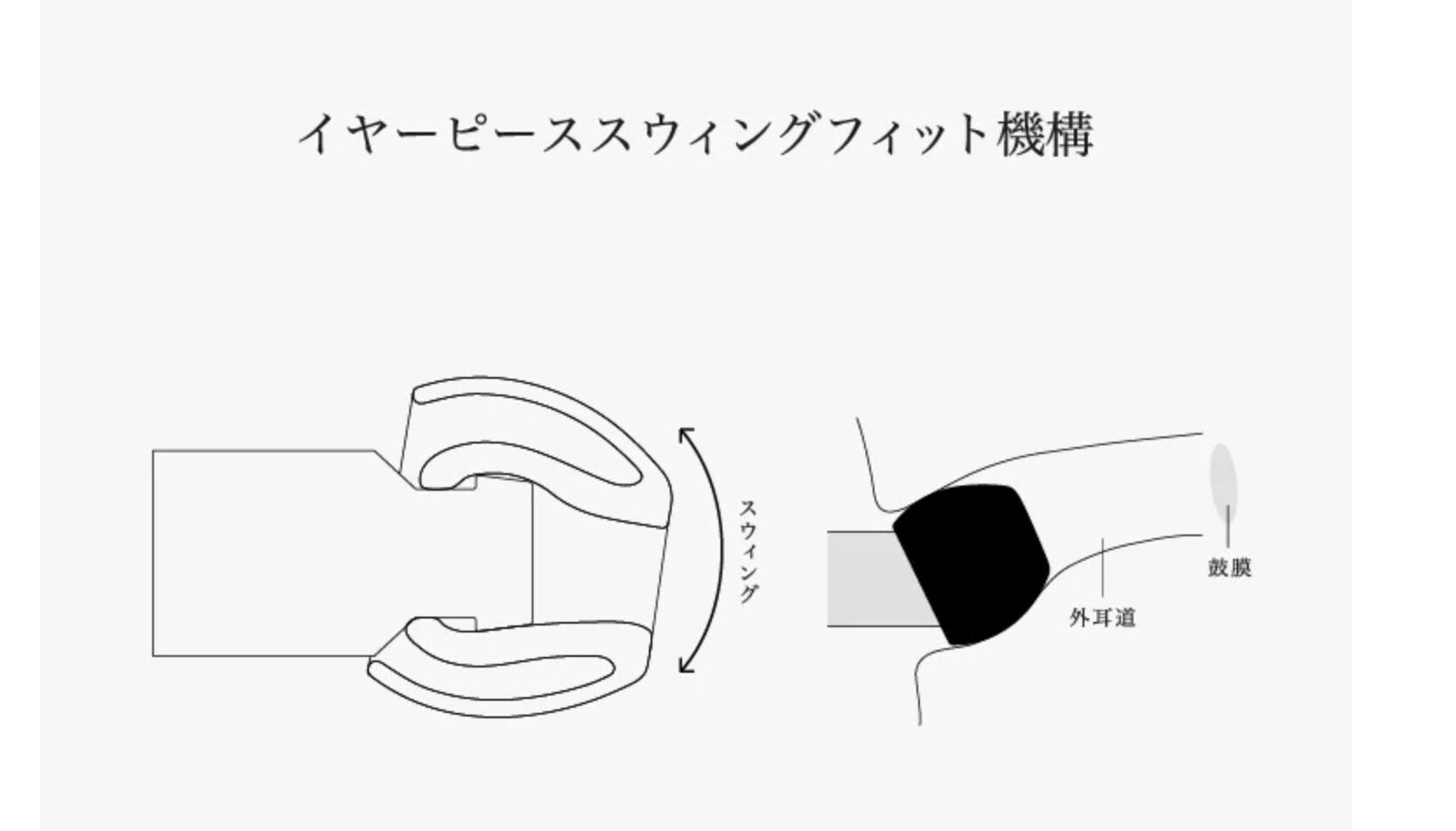

Isnt this angling just from the Type E tips? And not the actual nozzle from the iem itself, so using the type E on any other bullet iem should do this as well?
Is the inside the same? That is, the only difference is the outer look of it but the chamber inside is identical? if yes then yeah it should be near identical. If the outer look is different in mass then it should have minimal effect, however if that is noticeable is another story. If the internal chamber is different then the results should be different though.

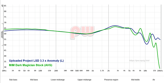

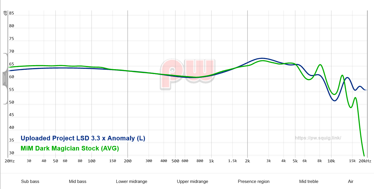

I combined Anomaly internals with the v3 or 4 O2 driver, same channel vents as shown in the above image too. This sounds stupidly good.

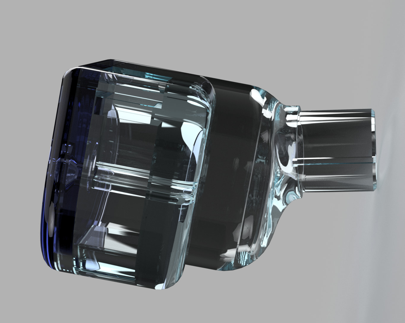

Illuminations driver(really) which is 11mm and BE coated. My first trials didn’t hit the mark though people enjoyed the tuning decently well. I did the OG design more than a year ago and learned a lot since then (of course). Decided to re-do based on my current knowledge. Mostly I needed to move the driver way way close to the ear drum. The more distance = less sparkle. Also instead of normal pinhole vents, Im trying the channel vents again.
Will this still be within long listening/rocking out parameters?
Being twinkle toes, the idea is to get the most details and twinkles possible. YMMV
Still, i wont put out a set that I wouldn’t rock, ever.

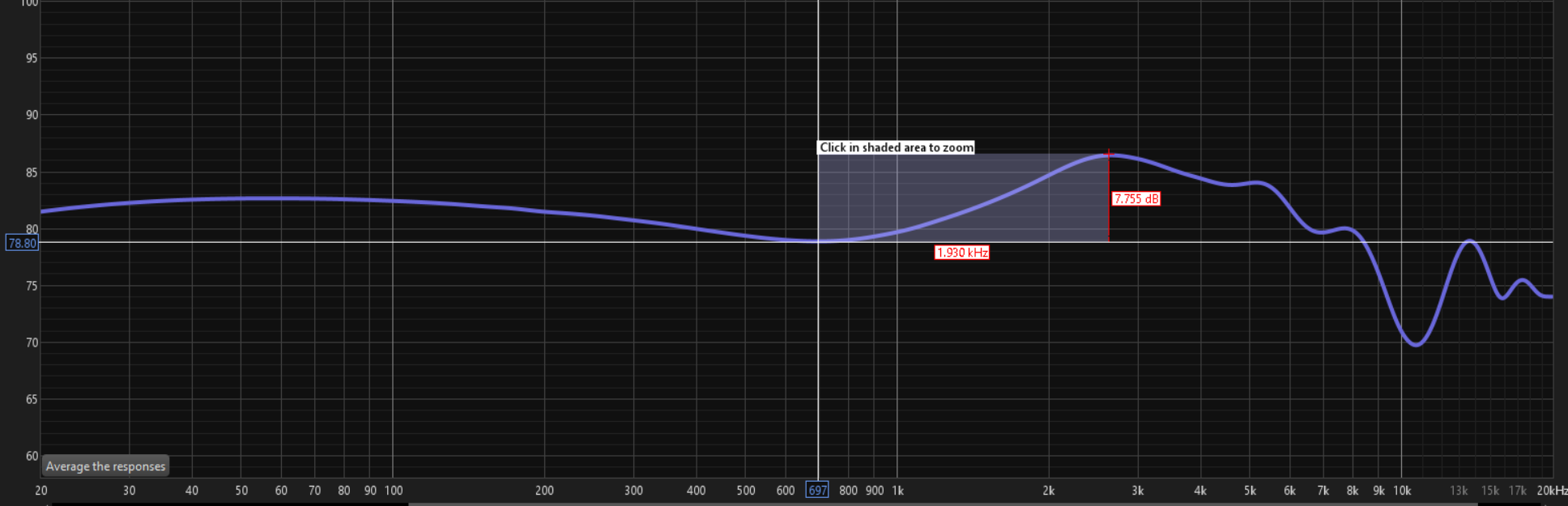

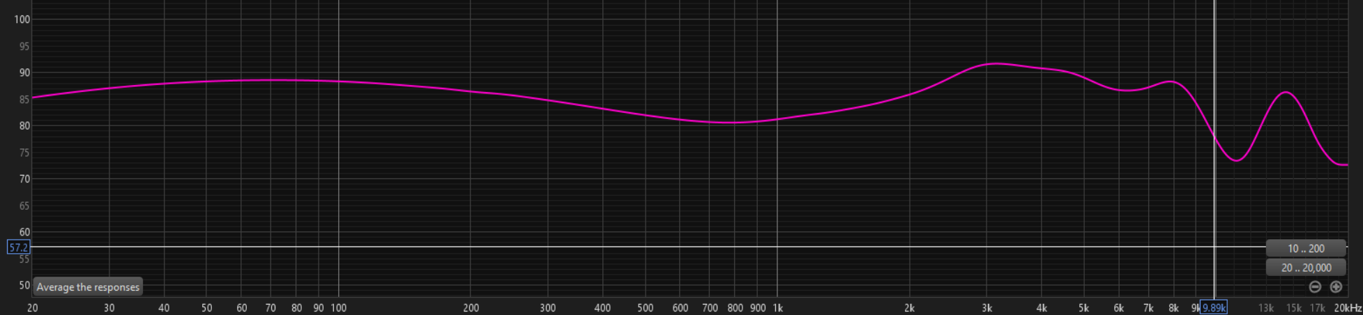

That shell turned into this graph:
It has nothing in the nozzle, as in zero.. just air.
jee, thats a win

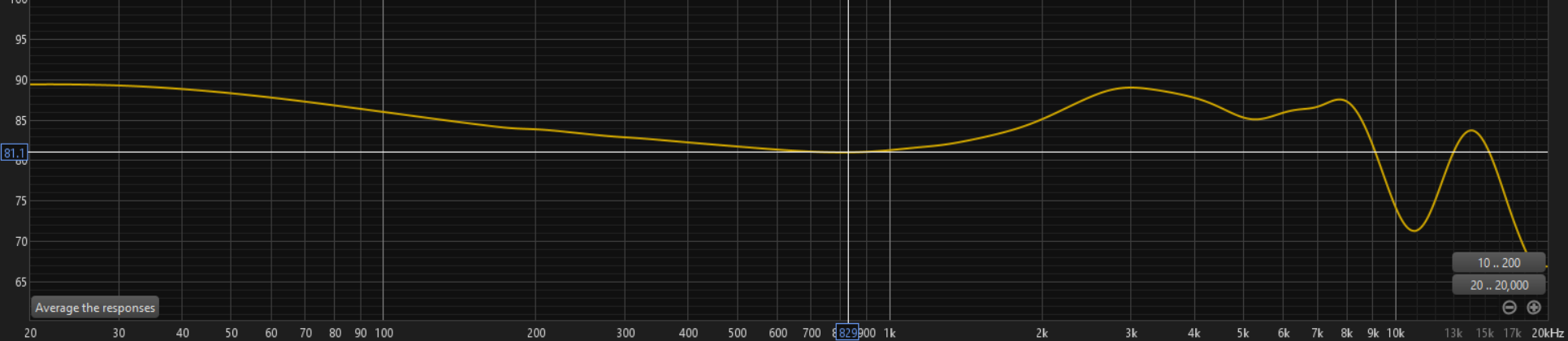

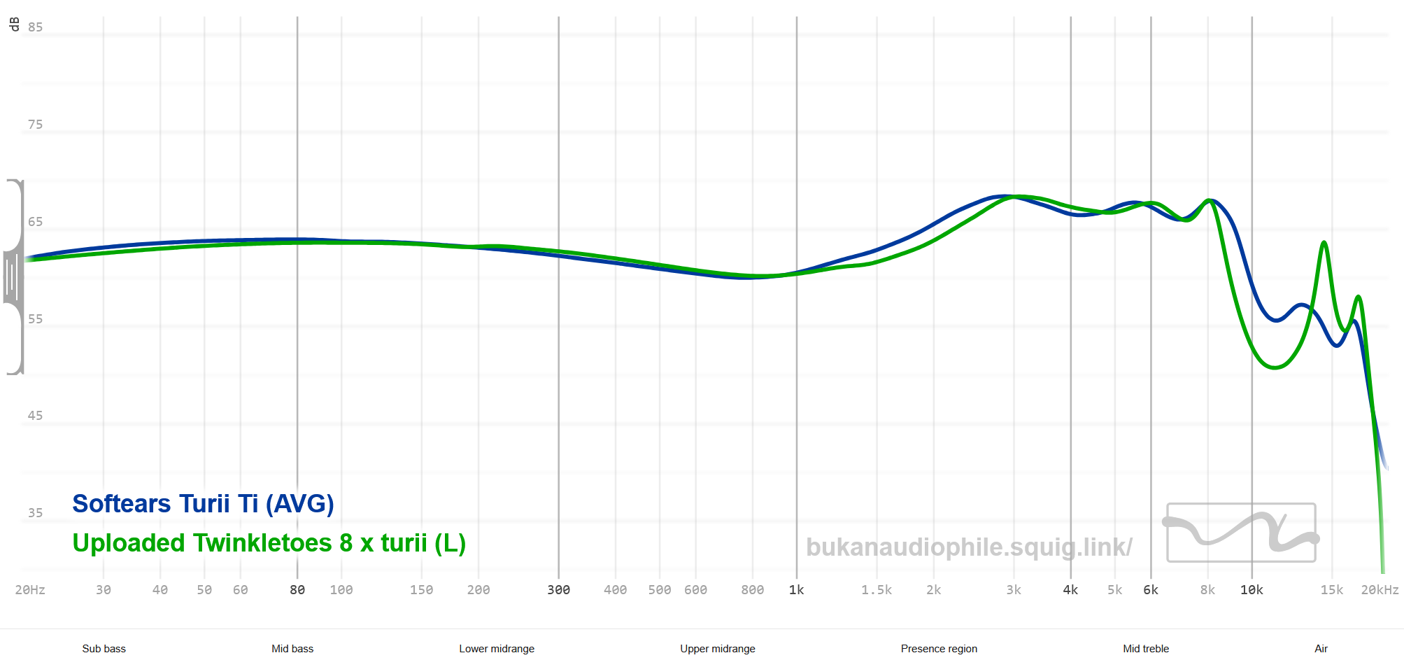

Further refining Twinkle Toes Shell. Waveguide tech implemented for the center of the 11mm driver. Basically this helps guide the treble from the center of the driver out the nozzle.
This sounds FUCK!

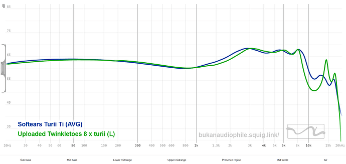

What am I looking at here, compared to previous post uploaded graph I don’t see much difference except for the bass vent.
Waveguide = above 10k. A little more energy.
Man I got Twinkletoes close.. so close
You’re really on a hot streak now :flexed_biceps:
