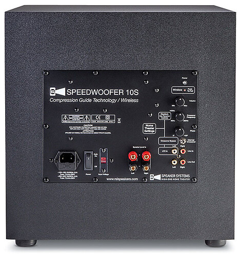

You’re gonna need 1 short stereo RCA cable, 1 longer stereo RCA cables, and 2 longer mono RCA cables. The links are just the type of thing you need, you don’t have to buy those exact units. The short stereo cable goes from the Modi’s RCA output to the Magni’s RCA input. The longer stereo cable goes from the Magni’s preout to the Speedwoofer’s “Line In”. This might be the trickier part so here’s a pic:
In the lower right of that back panel you see 4 RCA plugs. The top 2 are for Line In. The left channel of that Line In splits duties with the LFE signal - which is more for home theater use but when both L & R are used here it will work great for a home stereo setup. Use your longer RCA cable to go from Magni Preout to both the L & R of this Line In. Then, right below that RSL Line In you see L & R line out. Use the mono cables to from L out here to the L Adam speaker and the RSL R out to go to the right Adam speaker. Done.
