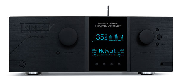

32 channels, don’t know can there be even more.
Indeed!
That’s the golden one. :heart_eyes:
That plus Genelec’s speakers… oh my looord. That demo was so freaking good.
