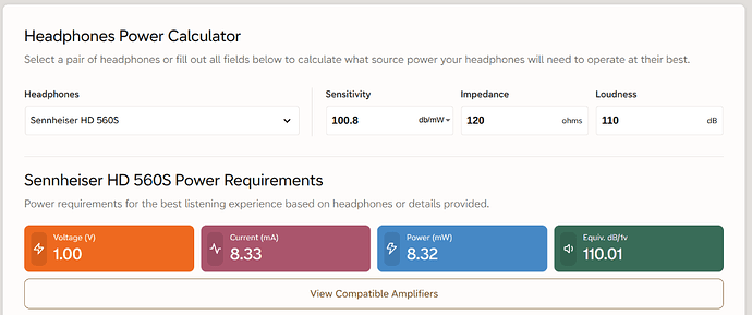

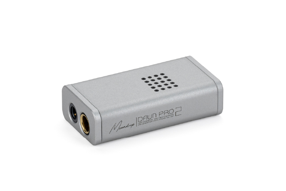

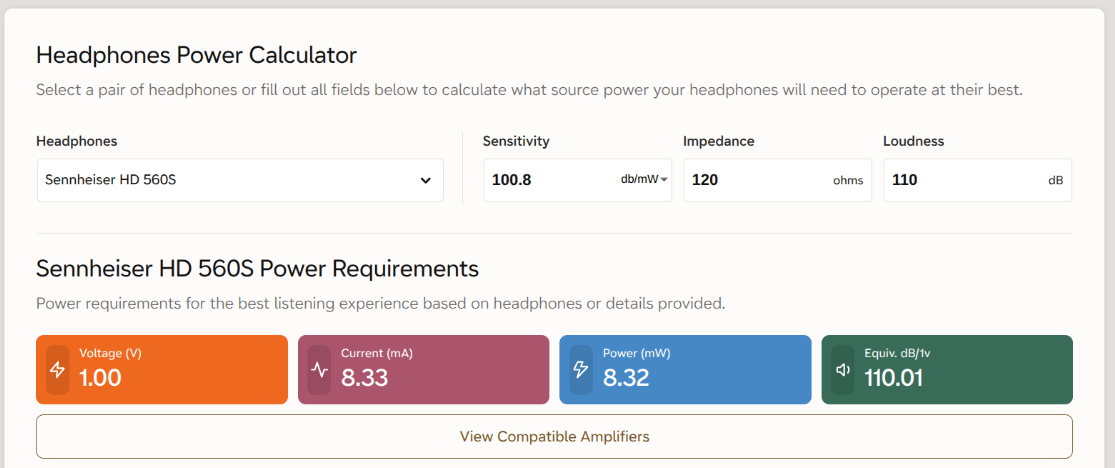

The Dawn Pro also has a paltry amount of power compared to a JDS Atom+ or an Element.
Demanding over-ears such as high-impedance Sennheisers and some planars will not be driven to their full potential with a dongle.
I’m FAR from someone who thinks you need a nuclear power station to drive headphones. Nearly all of the Chi-fi amps coming out now have WAY more power than needed – it’s just a useless spec war between manufacturers.
But 124 mW per channel is far less juice than 1 watt per channel. About 1/8th of the power, in fact. And there are many over-ear audiophiles who think 1 watt per channel isn’t enough (Pro tip: They’re full of sh*te; it’s enough power for all but the most demanding cans.).
Something to consider if you plan to drive demanding over-ears with this amp and not less-demanding IEMs.
