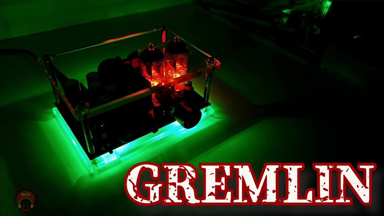

This is the official thread for the Apos X Community Gremlin
- Point1 Class A
- Point2: Fully Balanced Tube Hybrid
- Point3 1250mW of output power at 32Ω
