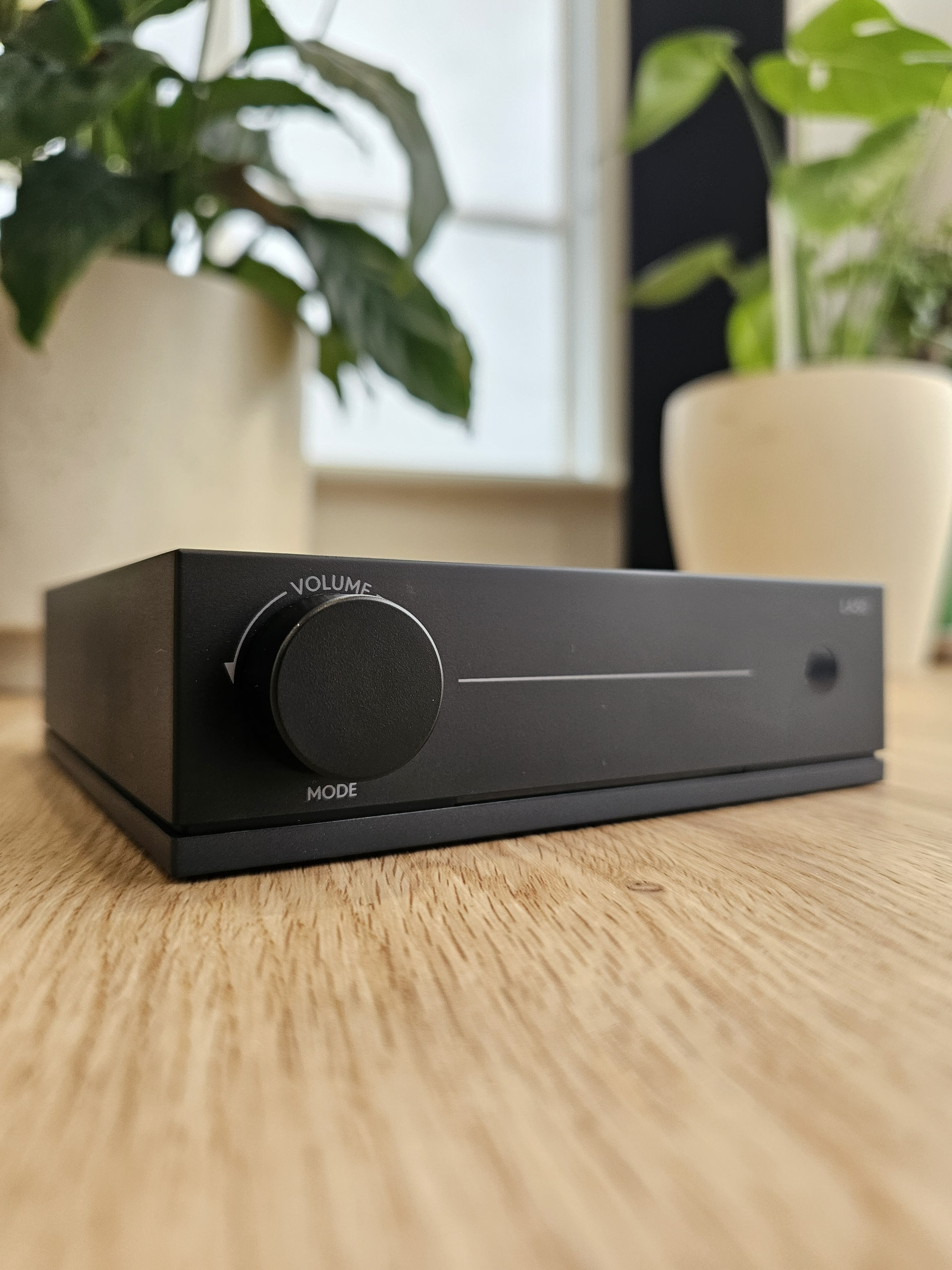

This thing is tiny, roughly 5.8 inches square and less than two inches tall. It is a very minimalistic and discreet design and that’s not a bad thing.
Looking at the front, it features a single physical multi-function rotary knob. You can click it to power on, click to cycle manually through inputs, and rotate it to adjust the master volume. The light indicator at the bottom will adjust to show the volume. This makes adjusting without the remote convenient. The IR remote doesn’t feel cheap, it feels quite substantial.
The back panel features gold-plated speaker binding posts that take standard banana plugs, which makes swapping out cables a breeze.
I will say, the device is super light. For some people, that’s probably a non-issue or even a plus, but my personal preference is always going to be gear with a bit of actual heft to it.

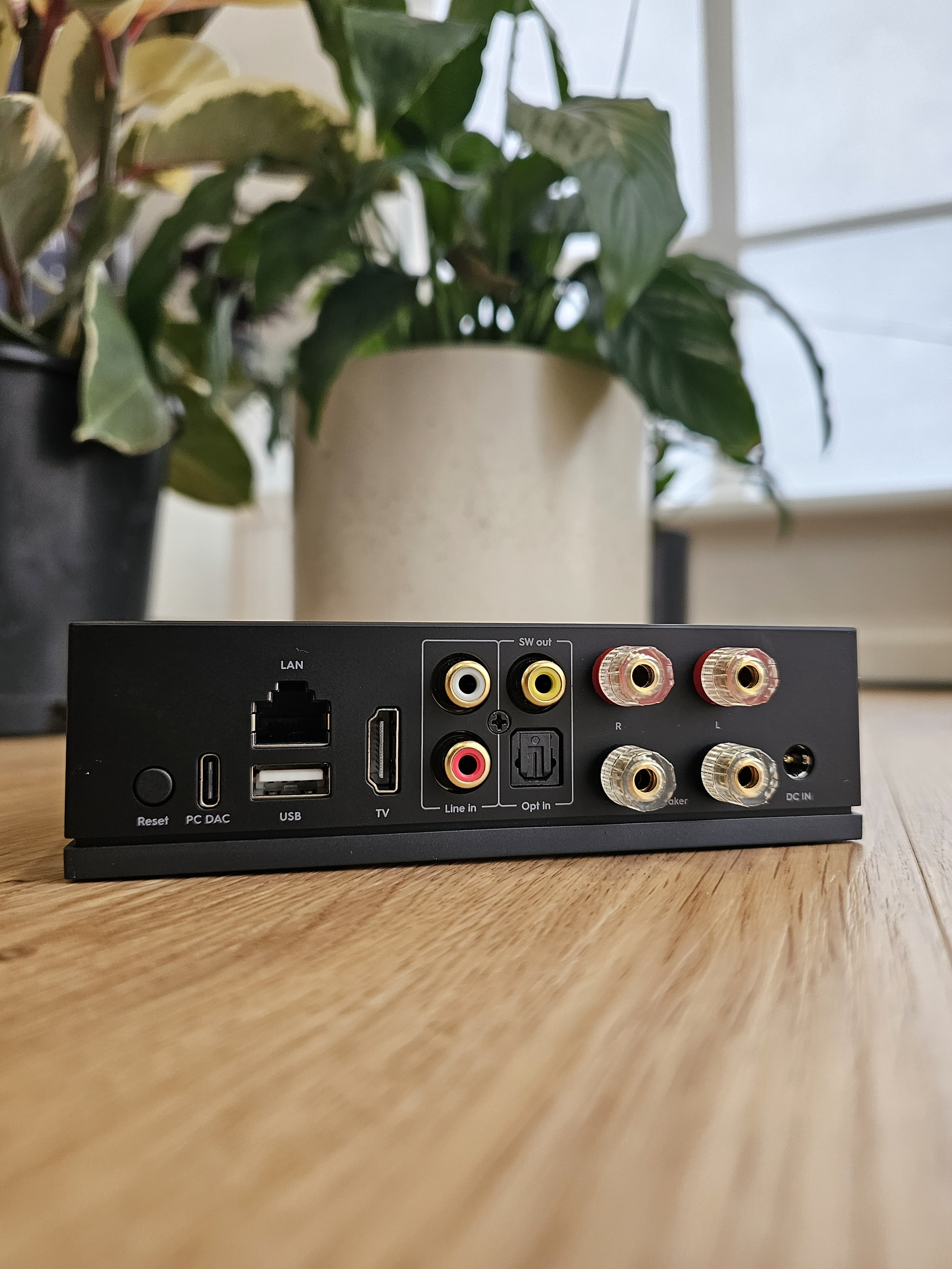

For a chassis this small, the back panel is packed with options. Here is what you can hook up:
  • An HDMI ARC port (for TV audio), a standard TOSLINK Optical input, a stereo analog RCA line-in, and a USB-C port if you want to use the unit as a direct desktop PC DAC. Note: The LA50 does not feature any analog outputs
  • It operates on dual-band Wi-Fi or Ethernet and features Apple AirPlay 2 and Spotify Connect, along with integrated support for Tidal and Qobuz through their companion app. It also features an onboard Bluetooth 5.0 card.

  1. The USB-C port is capped: Even though the Wi-Fi and optical inputs can handle high-res audio (24-bit/192kHz), the USB-C port on the back; the one you’d use to plug it into a computer; is capped at a basic 48kHz. If you’re a desktop user hoping to stream ultra-high sample rates or native DSD files from your PC over a cable, this box isn’t going to cut it.

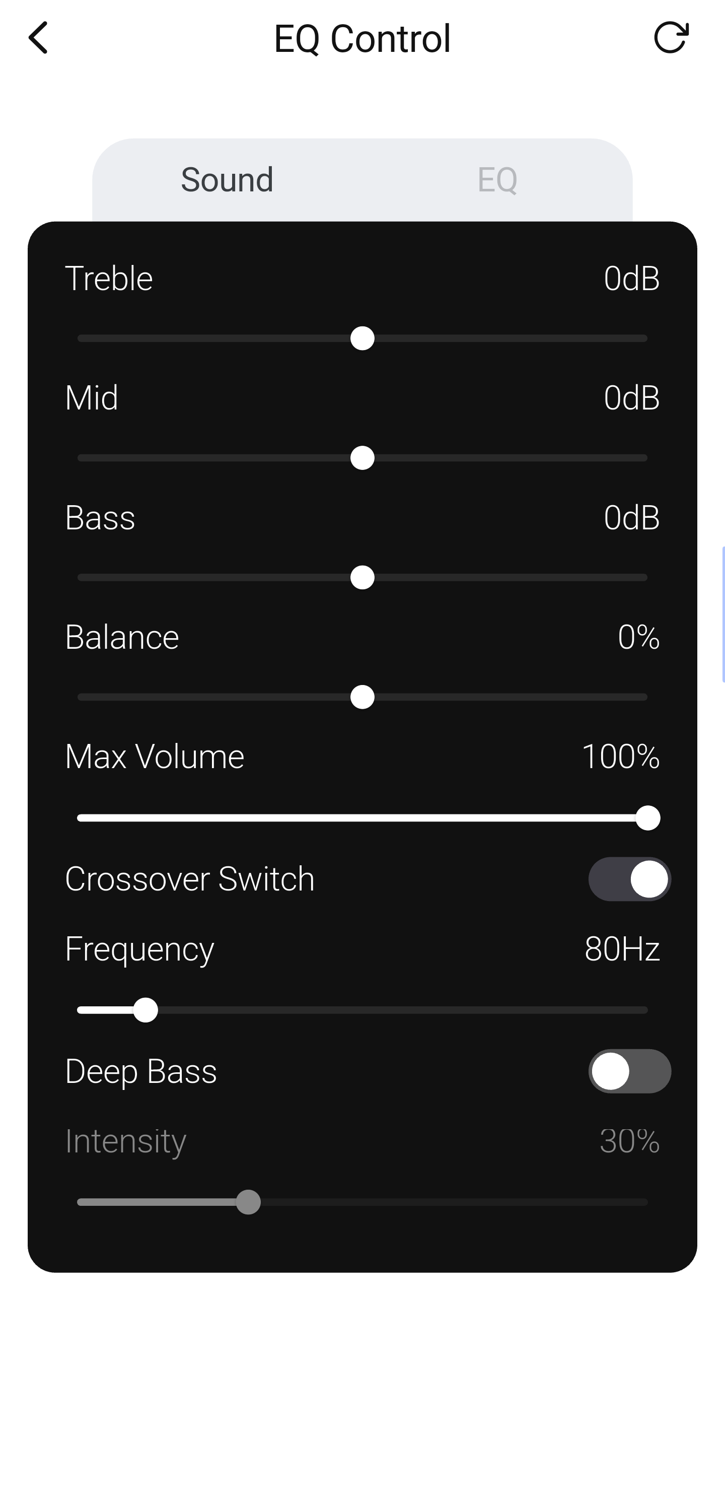

  2. The subwoofer crossover is…….shockingly high: The sub-out is fixed at a 250Hz crossover point. That means the amp is trying to send lower-midrange sounds; like deep male vocals; straight to your subwoofer. If your active sub doesn’t have its own built-in volume/frequency knob (a low-pass filter) to cut those higher sounds off, your bass is going to sound incredibly muddy and bloated.

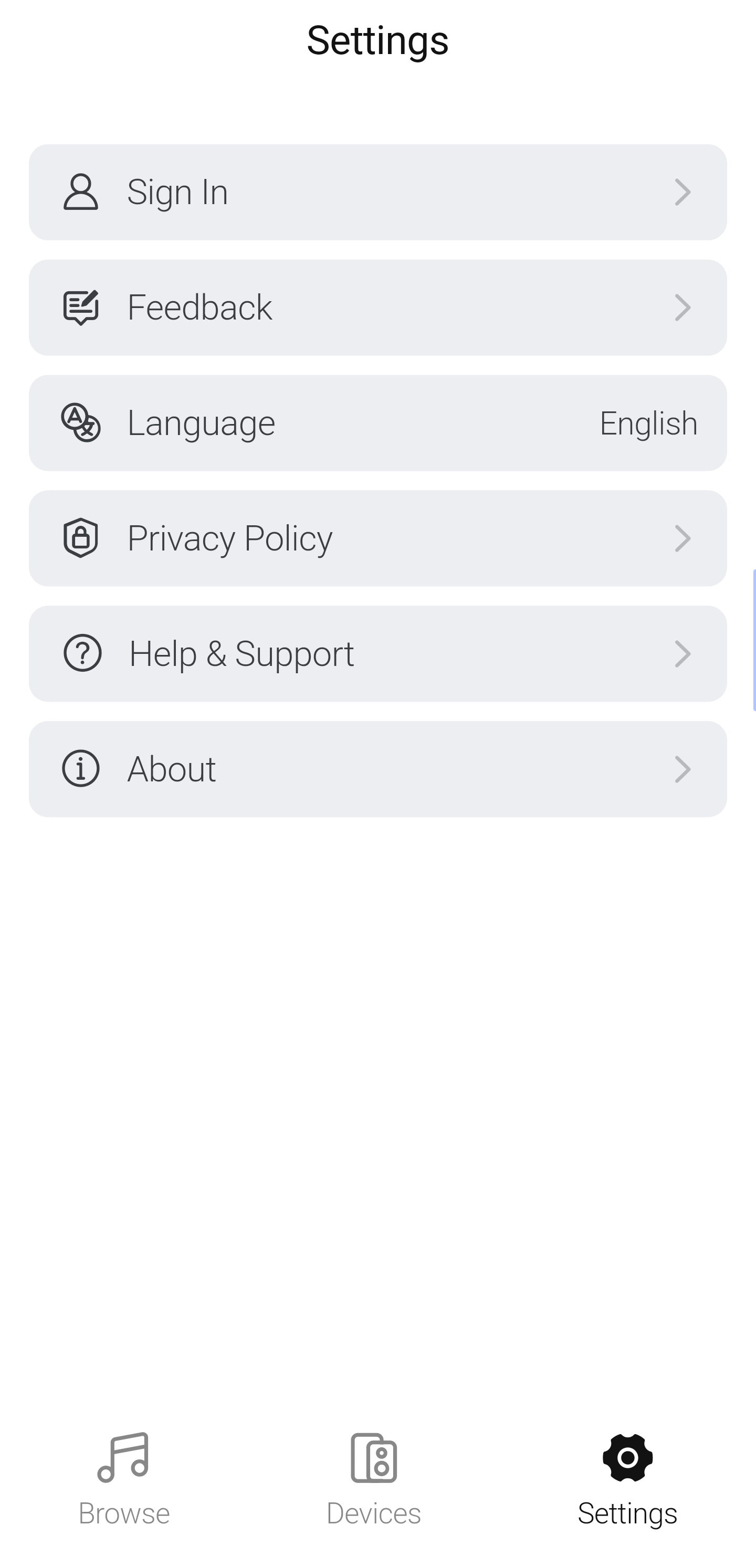

Getting the LA50 onto your home network, you have to use Arylic’s Go Control app.

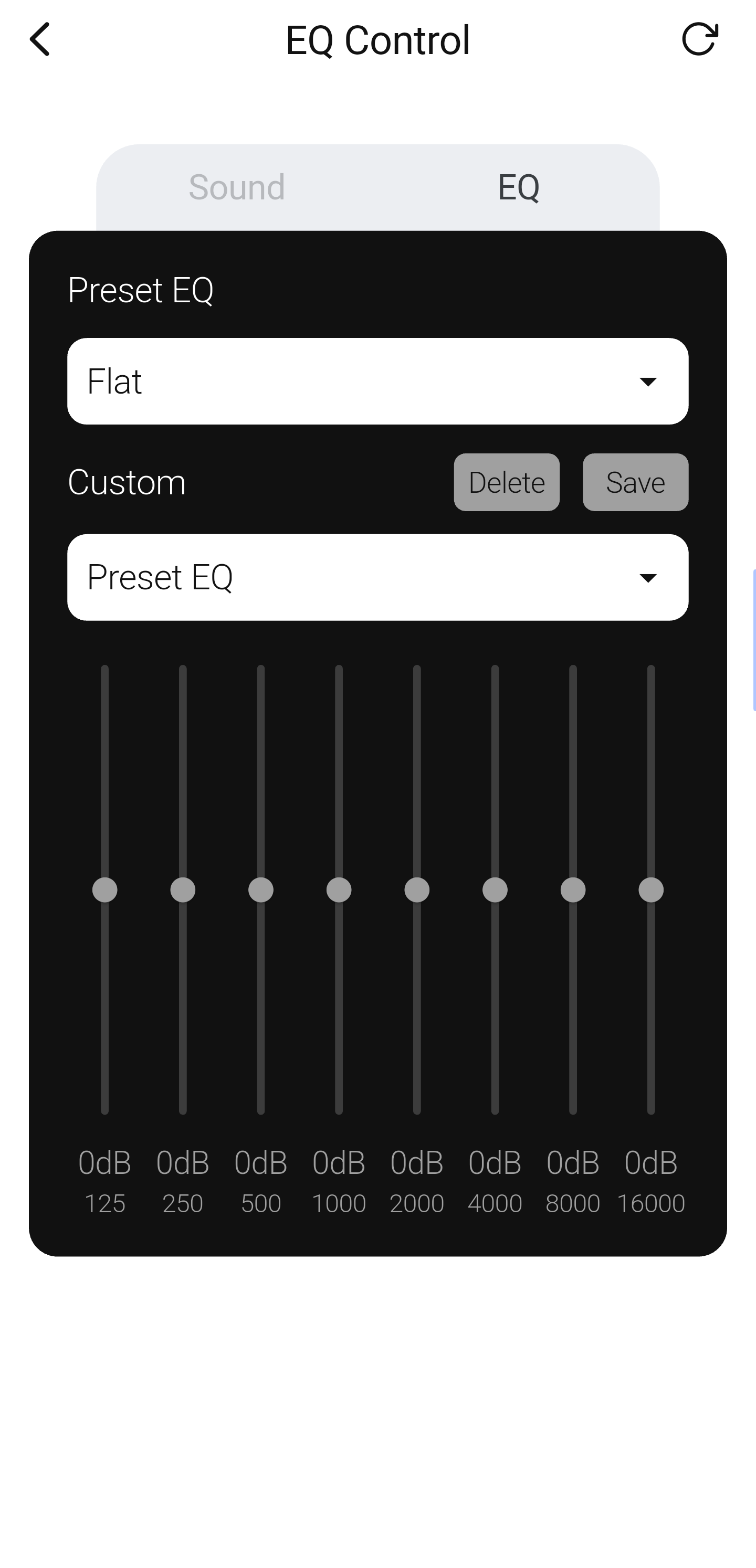

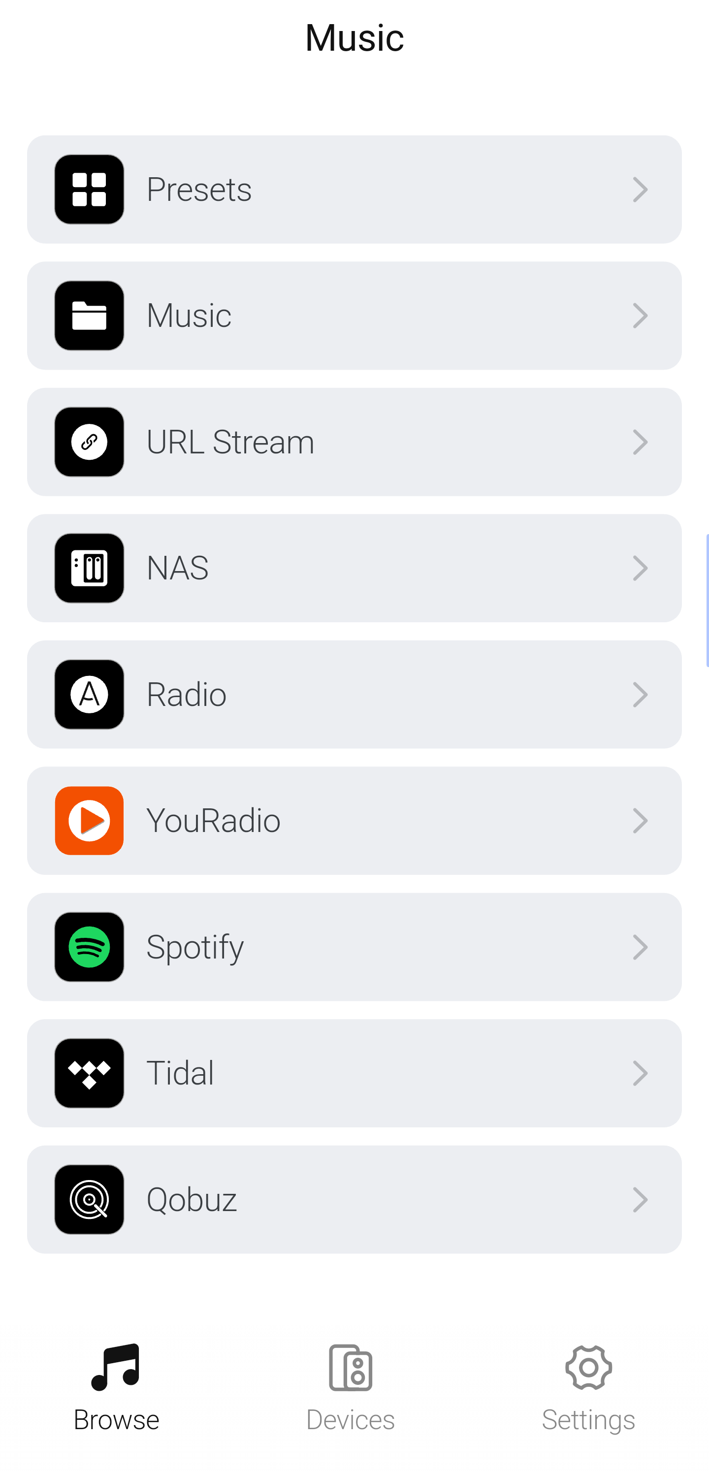

  • Once the initial handshake is completed, network stability is solid. Streaming via Spotify Connect or AirPlay 2 doesn’t stutter, drop packets. The app has 8-band graphic equalizer, perfect for dialing back any room boominess or adding a little extra kick to the bass line. The ad-hoc zone grouping is great. You can drag and drop different Arylic or AirPlay rooms together on a visual map to link them up on the fly. The Bluetooth card has a dual-pairing feature, meaning two separate phones can stay connected at the same time. It lets two people trade off music control seamlessly without the annoying “disconnect and re-pair”.
  • The app is super basic and simple to use, which honestly isn’t a negative for me. An app shouldn’t need a manual just to play a song; it just works. That said, I can definitely understand why some people might hate the simplicity if they’re looking for ultra-granular control and endless little adjustments to tweak.
