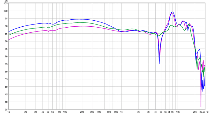

Not so much a chart but the entire frequency response changes rather drastically look here
Dekoni in green, balanced in blue, analytical in purple

I didn’t even mean frequency response so much as, if I’m holding one of the pads in my hand, what’s it called? Lol. I think I’ve been able to map it out thanks to seeing FR graphs and correlating listening experiences, but otherwise I don’t properly know which one is on my headphones and which is in the box. :slight_smile:

look in the back of the two pads. The one with the most holes is the balanced. the one with the fewest holes is the analytical.
Out of the box they have the analytical pads on you will definitely know if you have the balanced on they tend to be softer and have quite a lot more bass presence its a definitely V signature with those.
