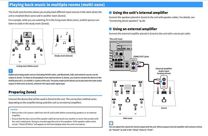

Ummm… your current Yahama has Zone 2 pre-out. Could you use that.
Zone2
Send signal/music from that to a External amp and separably control the volume for both amps. Haven’t tried it but this should in most AVR’s and work just like that.

You might be able to adjust the output in settings to send full range output

@MadGman
Thanks! I appreciate you looking in the manual.
This is how I currently have it hooked up:
-Zone 2 output to external amp input
-front speaker cables connected to external amp
-reconfigured menu setup so zone 2 is outputting to amp
-adjusted setup so output is considered full range (thanks @M0N!)
I am able to play music via Yamaha AVR (e.g. internal Spotify Connect) through Zone 2. So that’s positive progress!
