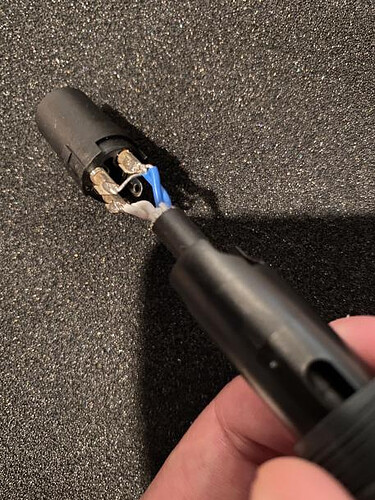

You can make a safe adapter from 3Pin XLR to RCA, BUT every commercial cable I have ever seen like this is wired in such a way it will short out the amp. I think @ericg used such an adapter on the balanced out of his Bifrost2, but he had to modify the cable before use.

My setup currently:
BF2 > RCA > Bottlehead crack
BF2 > XLR to RCA > SW51+
On the XLR to RCA cable, I had to snip the ground from 1 & 3..

Any particular reason why you went that route? The BF2 has RCA outputs

The BF2 manual specifically says not to use an adapter like the on Eric used above, because it can hurt it, because generally those adapters are designed to be used in the opposite direction where the input is RCA, and they need to be modified to be safe the other way around.
He’s needed a second set, so it was either what he did or use a splitter.
Mostly because those cables are meant to feed unbalanced into a balanced input.
The “correct” way from balanced to unbalanced is to use a DI-box (or specifically, a level converter).

Yeah exactly what Poly said. I wanted to feed another amp w/o using a splitter. :+1:
