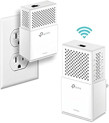

Home plugs have worked better for me than range extenders. They use the electrical wiring to transport you internet connection, and a lot of them give you the option to the use a cable or wifi.
Couldn’t find the one I use but it’s something like this.
Just make sure they are on the same breaker otherwise you might get poor or iffy performance
That’s what I was told, but I’ve never had a problem using them on separate groups. I’m sure there’s some degradation and in some cases it might not work at all, but I’ve never had two of them installed in the same group and I’ve never had any problems (always made sure I could return them if necessary though).
