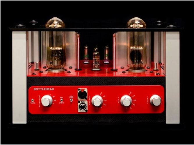

They make their TOTL amp called “Mainline”. I built this one and had it for several years, works well with hi and low impedance cans …
From BH:
“Output power is about 600mW. Input impedance is 25Kohms minimum. Gain is around 12dB into 32 ohm headphones at the low impedance output setting. We have used the amp with everything from low impedance Grados to high impedance Sennheisers and even power hungry Audeze phones. They all sound great.”
Alex
I’m just going off of my experiences, I personally don’t prefer any planar I have tried off a mainline or s.e.x. The only bottlehead I liked a planar off of was the neothoriator (I wish they would make more of em lol)
They of course still work fine on a mainline or s.e.x, just imo not the most ideal pairing, would personally rather have a hybrid or quality solid state in the price range

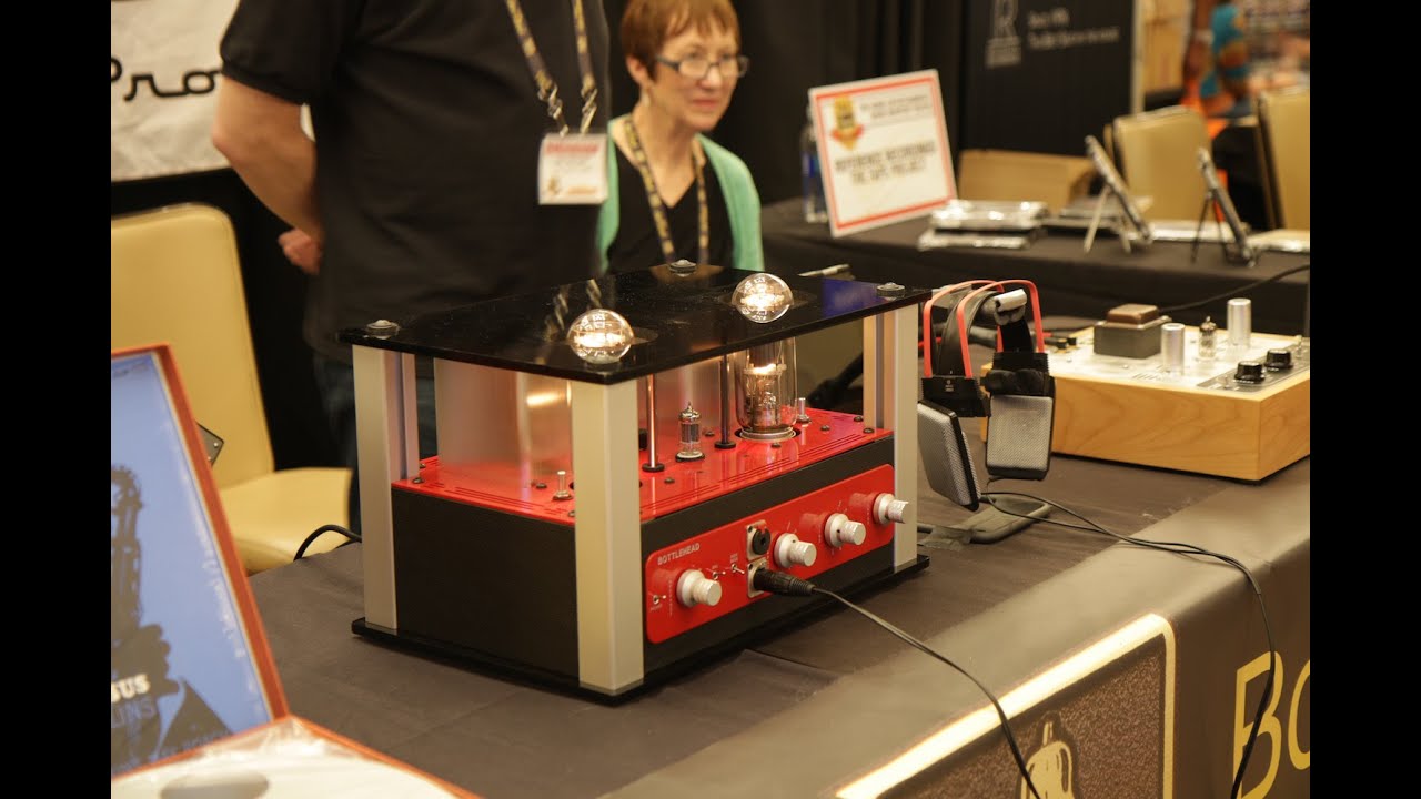

$10,000.
As of a few weeks back Doc has one for sale!
I would pick it up if I didn’t already have a 845 headphone amp already, I just recall it being sweet when I tried it at a show
Also I’m surprised there is one for sale, I thought they only made 2 of em, just kinda figured they would have been snapped up
Yeah only 2, but its on the BH site for sale…another website mod is thinking of it as well…I would love to have it, but the retirement budget just wont go there!! LOL!!
Notice the poor Mainline on the right!!!
