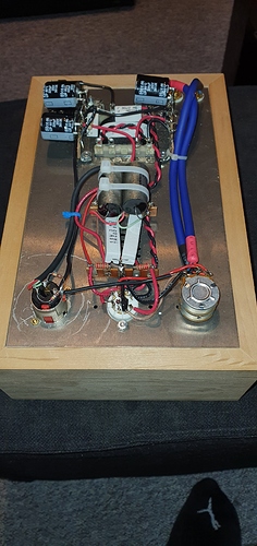

I’ve been working on spiffing up my Crack, it’s finally finished being spiffed.
When I originally got it used , it needed a bit of TLC. It was professionally built and well built at that but the ground plate was covered in a half-assed powder coating job and the box had been bonked in one corner.
Before:
And After:
I’m amazed that the carpenter I took it to said he could fix it with steam and a hot iron. Completely straightened it back up and bull nosed it a bit, gives it a softer period look. I’m very happy with the way it all came out. I spend a lot of time sanding and finishing but it now looks as good as it sounds.

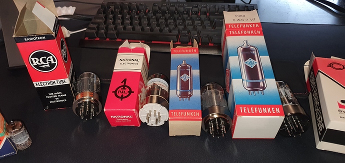

The owner of the crack that I bought has just sent me this picture of tubes he has for it. I don’t know what they should cost, I will talk to him. But maybe someone can see something there that I should get.
Unfortunately I can only upload a screenshot.
Scroll through here and see if you can identify any of them:
Thank you, that is useful! I´ve had a phonecall with the seller and he will send me more infos of what he has there. I will see what i get than. Cant spent so much money since i didnt want to buy a crack and bought a crack haha.
