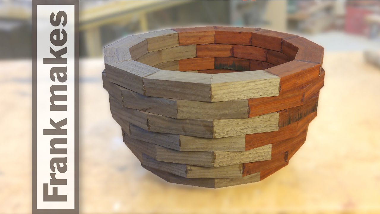

  • Wooden rings can be cut and stacked to form cups. With some turning or sanding you can get them nice and smooth. A lot less messy than resin… just dusty.
    The rings can be sawed by hand, scroll saw, laser cutter, cnc-router, etc.
