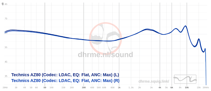

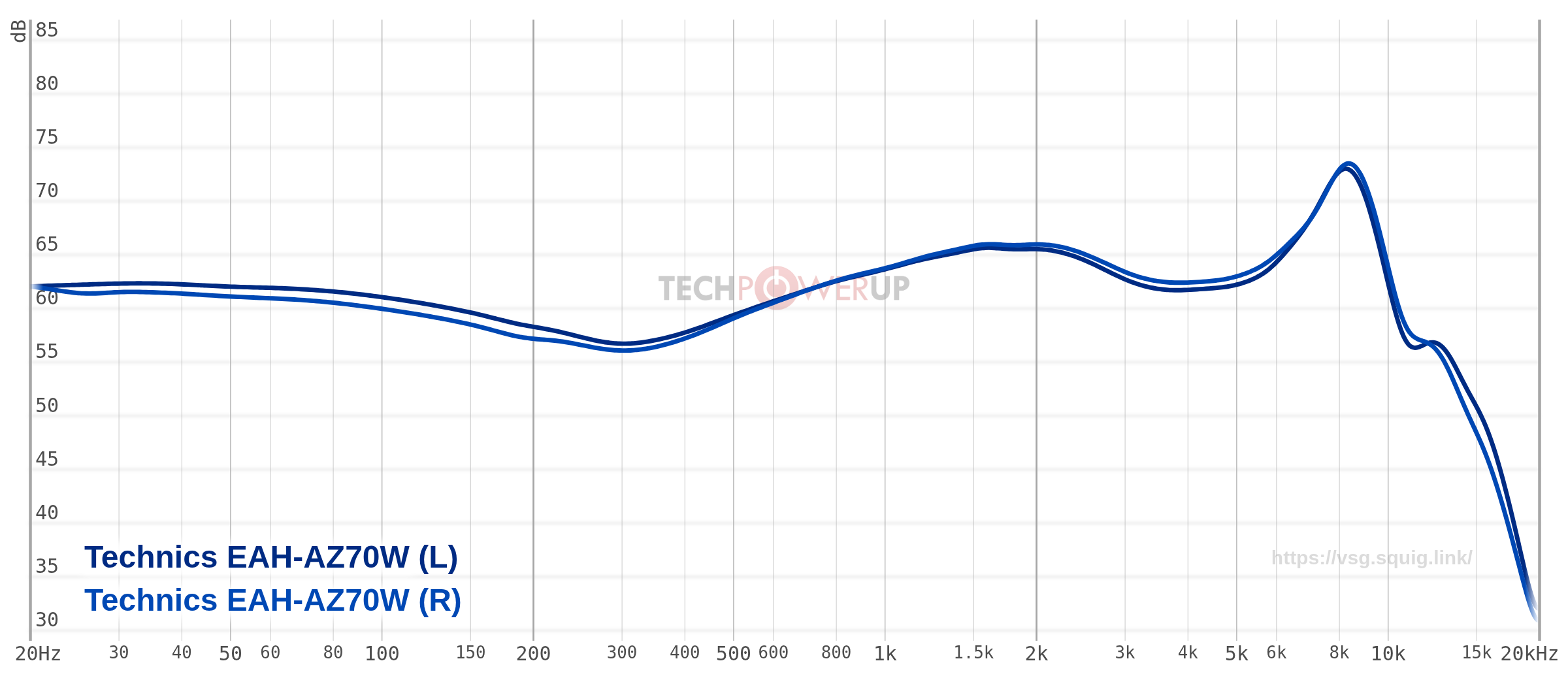

No graphs of the AZ60 out there afaik but.

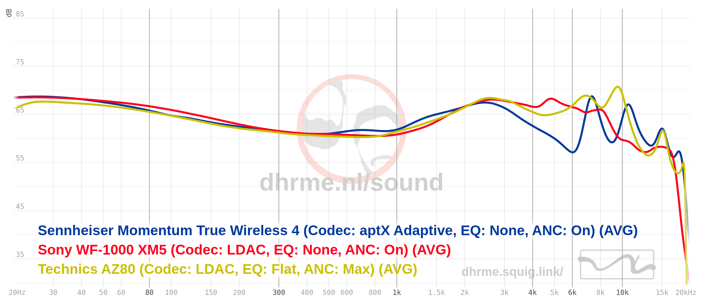

if this is anything to go by the Sony XM5 is fairly similar to the tuning on the AZ lineup and if the AZ was too sharp for you neither of them look to be much safer for you tbh…best would be to pick the one with the best EQ app and lower the treble there (or just use a PEQ app that works with everything like Poweramp EQ),
However if the MTW2 works for you it sounds like your sensitivity is arond 3-6k area which is notable lower on the sennheiser tws. so i would go for the MTW4.

Well actually I tried both the Senns and the Sonys and went with the Sonys. I like that it’s flat ish but with sub bass and it still has treble, but no treble peaks. The Senns have treble dips, it’s a bit too much.
