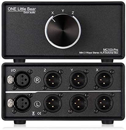

XLR to from my M200 DAC (D90 backordered) to this switch. Then I ran XLR to my 353X, LP, and A90. My schiitty tube amp is fed via RCA. No issues whatsoever.

If you have enough outs on your DAC (e.g. XLR to one amp, RCA to another), you could use something like this to AB test:
Just make sure you do a decent job volume matching the two before trying to make any judgements (louder usually sounds better). Look forward to hearing your results!
