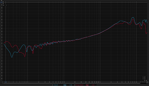

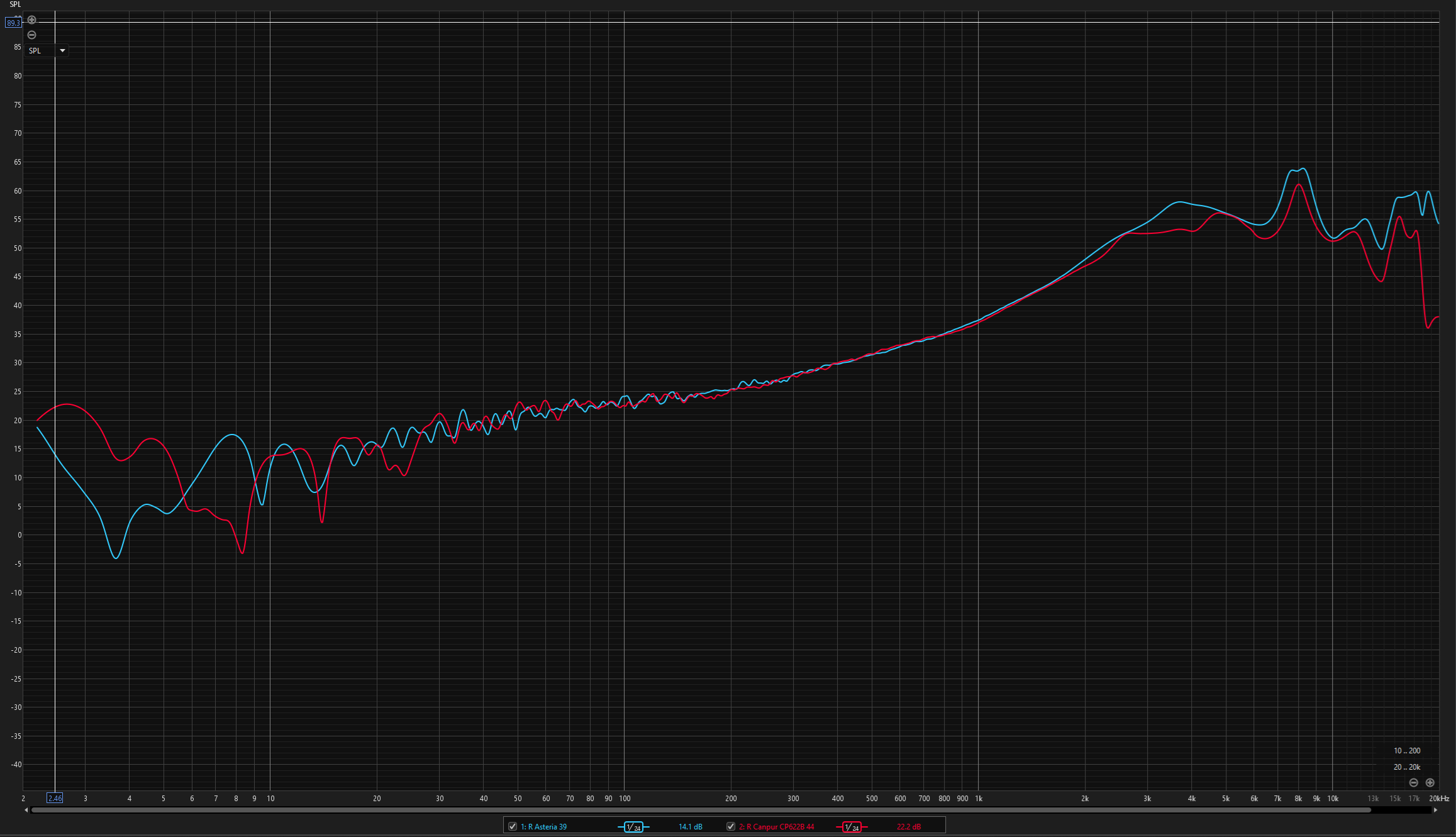

First I tried REW software, it has super lowered sensitivity below upper mids

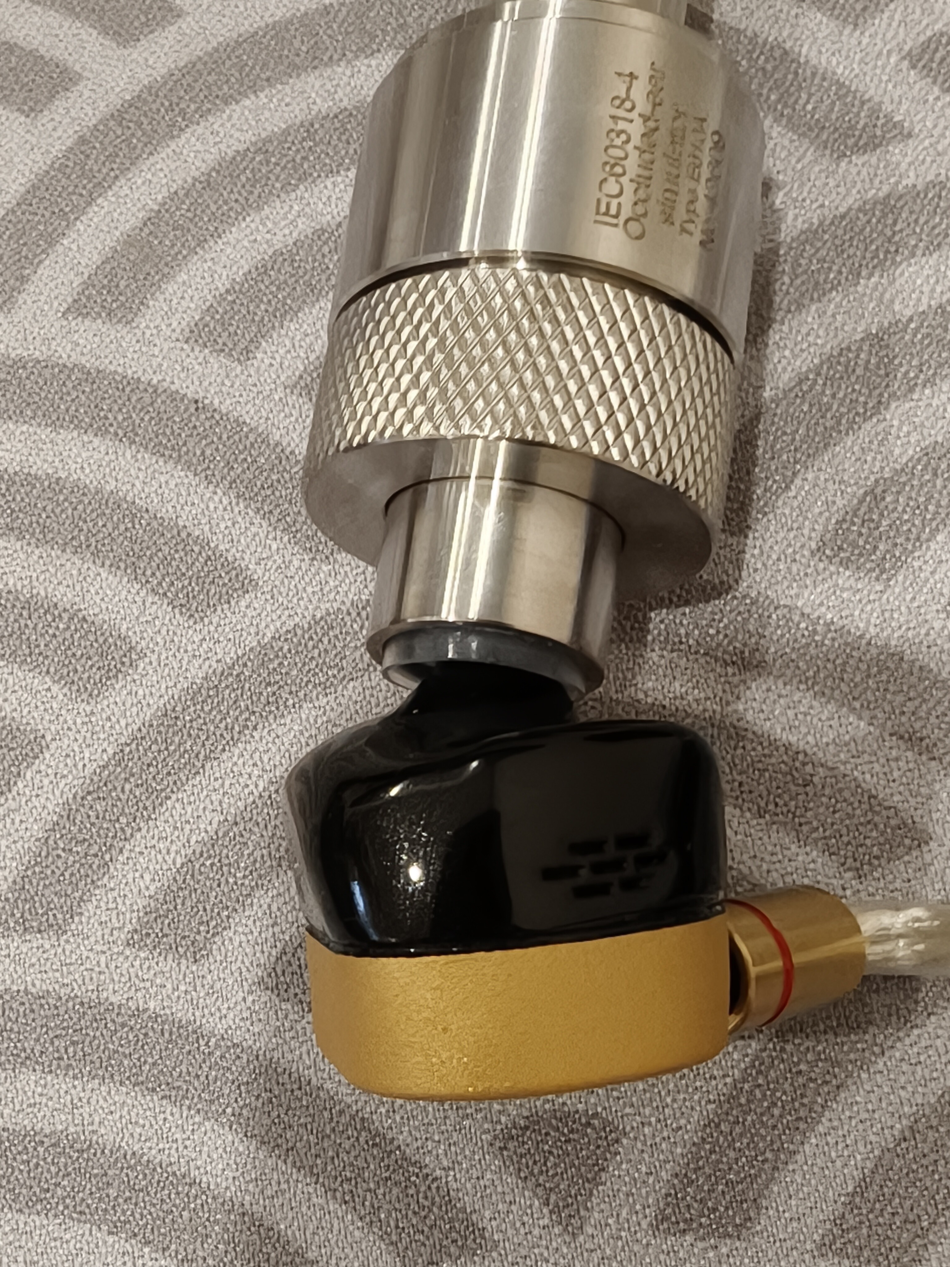

Seal is good:

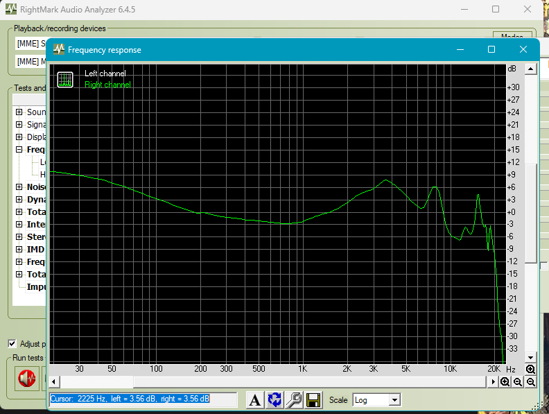

Then I tried RMAA6 and it worked, so the coupler is not dead:
The difference is REW is using sine sweep and RMAA is using multitone test.
Enabling mic compensation file in REW only affects treble by a couple dB.
I’m not sure what’s wrong with REW and if I should change some settings. I’ve tried stable and beta REW versions. EQ is disabled everywhere and windows audio effects are also off.
I mean you should get the FR by running Farina Method on both the couplers.
Multitone should be reserved for non-linear distortion only.
Looks like something is wrong with the compensation itself which shouldn’t be the case because it’s RAW As far as I can see.
