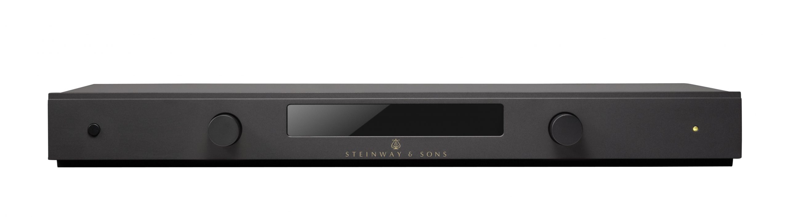

Well, that changes things! For piano music you have to stick to Steinway:
