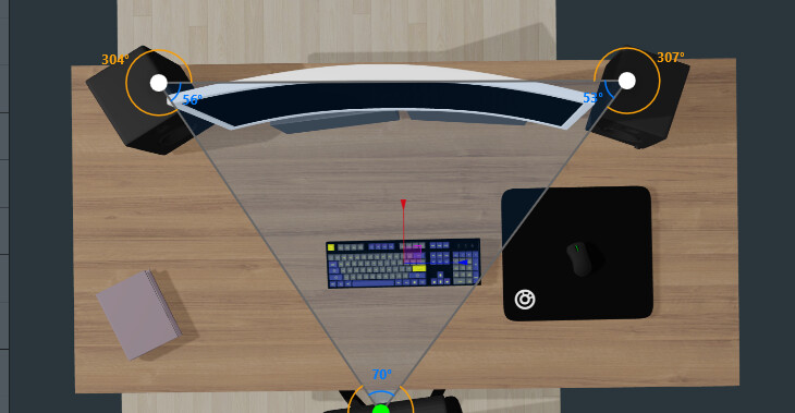

I’m currently redesigning my desk setup. Likely going from 2 screens landscape (27” + 24”) towards 32” + 27” portrait). Currently I have Edifier S350DB 2.1 and the speakers fit under the monitors so it was a good listening triangle, but not the best speakers. With the new monitor setup the speakers will not fit under. I’m also likely upgrading to Buchardt A10’s which are also a lot larger :slight_smile: .
As aresult the speakers need to be wider, ruining the equilateral triangle… The TO BE setup would be like diagram below. For now ignore the visual perception that the screen will be in front of the speaker, I can put them a bit backwards so that’s really not the case.
So question 1: How badly will sub optimal listening angles impact my listening experience? We’re talking about minimum 75°, maybe slightly upwards. What exactly will deteriorate?

Plan B is to get a 32”, 34” or 39” centre monitor and jsut put 2 15” monitors under. And then no larger screen to the side. But the other monitor setup is really what I prefer. That would solve speaker placement. I only wanna go this route if listening experience is ruined too much under question 1. Else it doesn’t make sense to buy super premium speakers. Another option ofc is not sitting dead centre on the 32” screen, just sitting at the 1/3 point will already significantly improve the listening angle, but that’s not a compromise I want to make. (see EDIT: The 39” monitor apparently is not a good solution ;-; )

EDIT - Actually using the 39” apparently isn’t even “a good” solution… Just shift the triangle backwards, I could put the point of my head back far enough so I just “moved” it forwards a bit. This also generates a 70° angle.
Ok - so I’m no expert, but I’ve been playing with speaker placement a lot, and am in a very similar near/midfield space - a large, extended desktop essentially. In such an environment, I would wager that having that right speaker crammed into the corner like that, and the left speaker against the wall, but not symmetrically in a corner will have a much bigger impact on that magical “in a bubble” stage you were referencing than a 10-15 degree opening of the listening angle. While 60 degrees is a great starting point, a little wider or a little narrower can often be a better ending point, depending on factors like your room setup, loudspeaker model, and presence/absence/placement of subwoofer(s). Every speaker placement deep dive I’ve read tells me to start with the equilateral triangle, but by no means consider that “optimal” or even “final” - play with your speaker placement, and also play with the toe-in.

For example, can you lift the speakers off the desk? Even several inches can help move those first reflections off your direct ear path. Can you get the tweeters at about ear-height? That would do wonders for your Nearfield image. Can you get them off the wall? Again, any distance you can put behind them, even a few inches can help.
For the love of all that sounds musical - put SOME sort of treatment on the wall behind them- a 2” thick rock wool filled box covered in cloth will do SO MUCH MORE for your sound than the difference between 60 or 75 degrees!
In my own setup, similar in scale, I found that wall mounted speaker stands gave me the flexibility to put my speakers at the right height for tweeters to be on-axis for my listening plane, got the speakers up off the desk, and bought me nearly a foot of distance behind the speaker cabinets (nearly 2’ behind the baffles). Maybe similar wall mount stands would help you out? Also, an under-desk keyboard and mouse drawer REALLY helped by moving my sitting position back more than a foot, helping the stereo angle as well as giving my speakers some breathing room.
