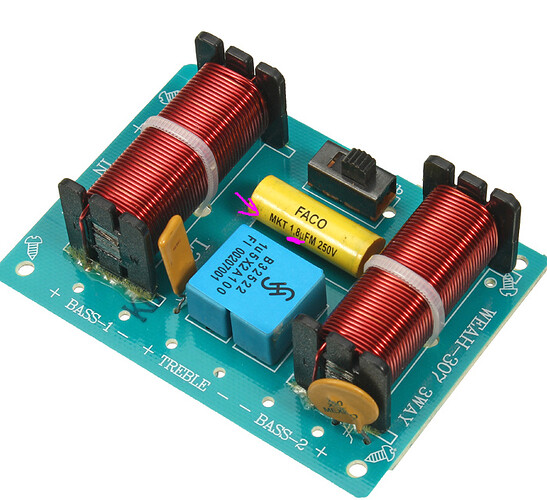

Should be as easy as pulling the crossover out and looking at the numbers on the capacitors.
For example:
You want the same uF (or nF) capacity, and the same or higher Voltage rating.
