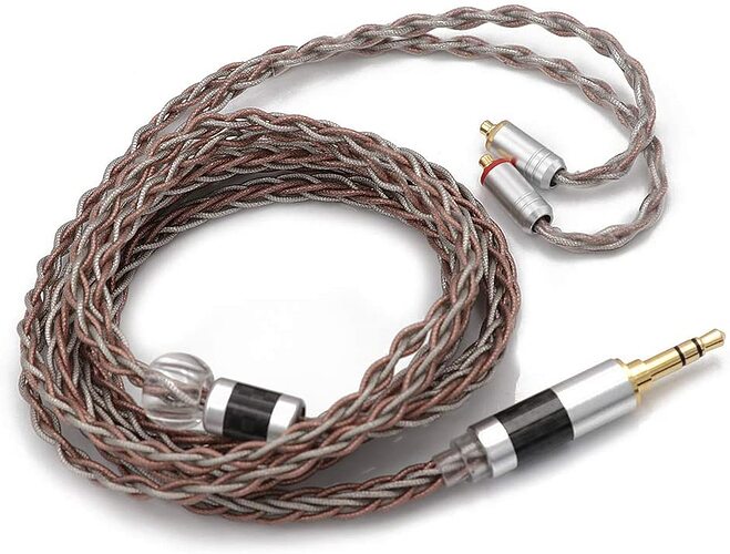

this cable i hear more hiss/crackling sound
i cant hear it on this cable tho(this is the default cable)
Different cables will have different impedance, but it won’t make like a crackling sound, that just sounds like a broken cable (if the crackles are inconstant). Both are unbalanced correct? Do they crackle or make noise with movement?
The first cable is not broken im sure.yeah both unbalanced.the first cable make noise even without movement
Is it a constant hiss (also just to check what do you mean by crackling noises)
it is not constant hiss…it crackles every 1 seconds it is weird i cant describe it
Hmmm, perhaps clean the mmcx connectors and the 3.5mm, and see if anything changes
i will try that
Typically if it’s crackling it’s a failing connector (is it in both or one ear?) or some sort of interference but that’s rare. There is also a chance that the default cable has a more secure and better fitting mmcx than the aftermarket cable
I hear it on both channels.yeah i think it is because the mmcx connections.because the first one got lose connection, while the second got tight connection
I would say that would be it then
It could be poor QC.
