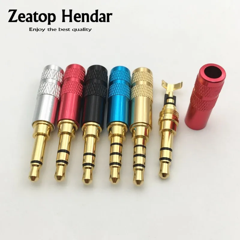

And this one for the hardware:

The connectors seems great, got any recommendations for 4.4 / XLR ones?

That store I linked above is where u get all kinds of hardware.
https://www.aliexpress.com/item/32675559061.html
