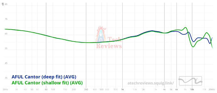

As for the sound question, deeper vs shallower fit does affect the sound. Deeper fit will push what you see on most graphs on squigs as an 8k peak higher up.
