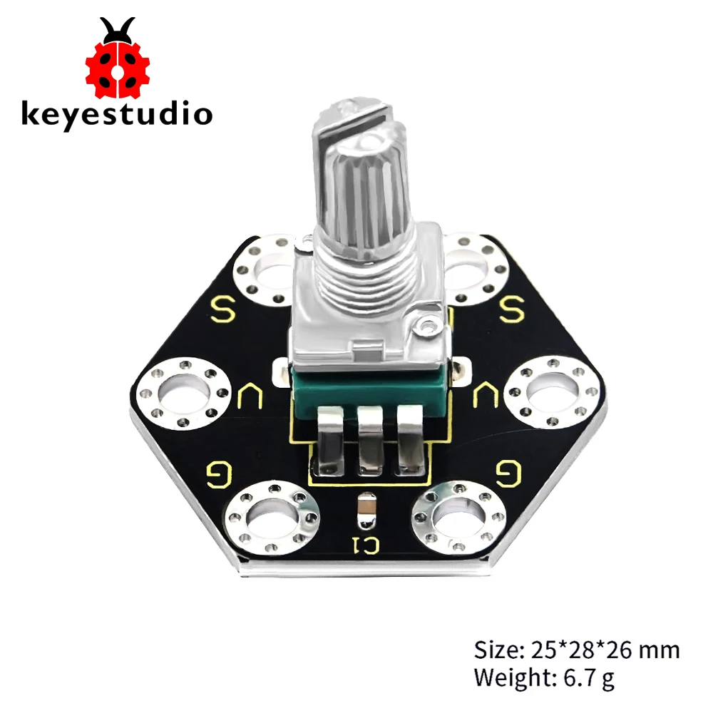

You may want to buy this board and replace the pot. The package looks the same, but I don’t know what about the values
Edit: oj shit, that is an old post… Hope that you got this done
