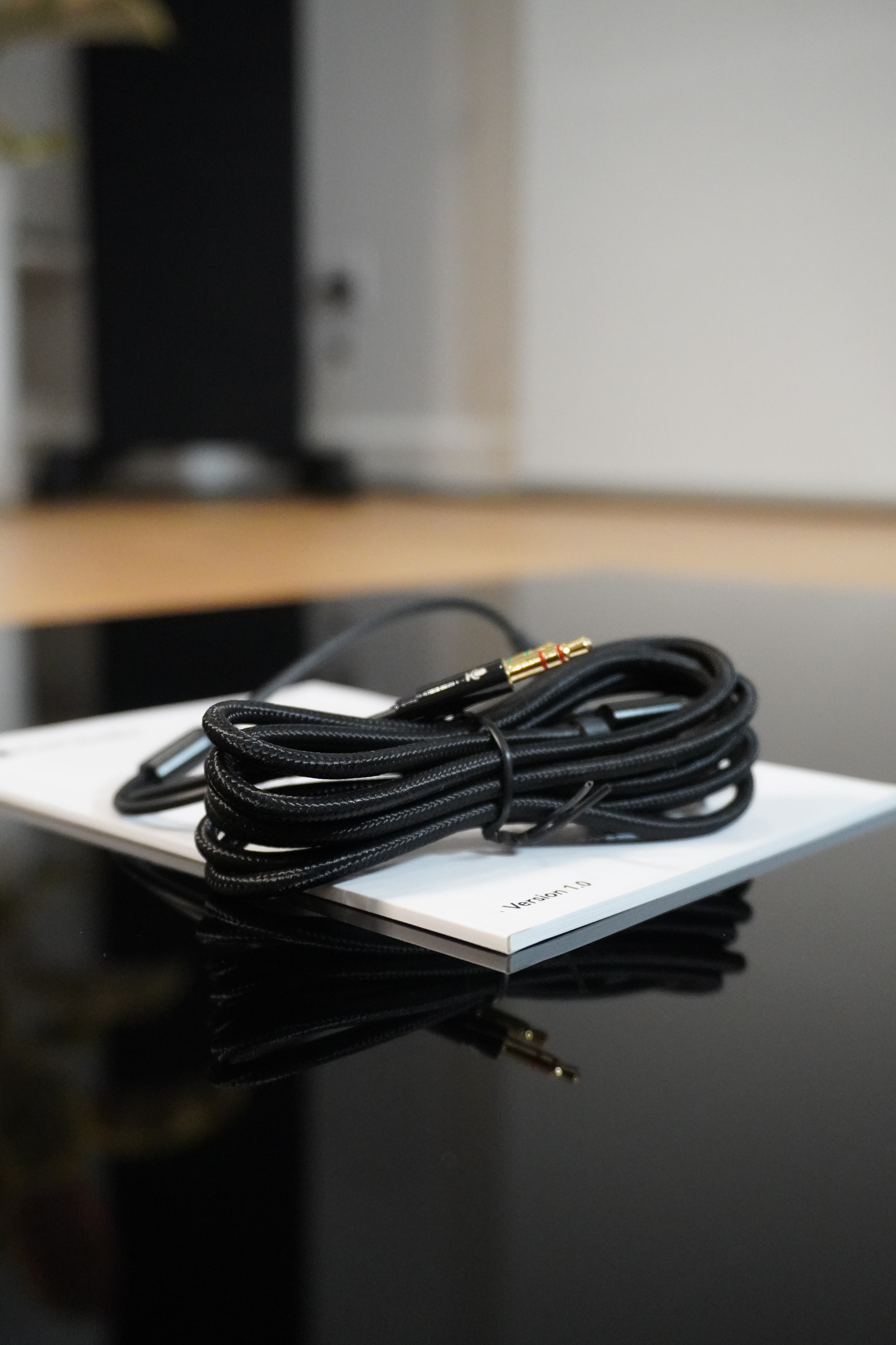

  • USB-A/C to USB-C Cable: A braided long cable that handles data and 5V power from your machine. The PC side has a tethered USB-A adapter attached to the USB-C plug, so you don’t have to go hunting for a dongle if your motherboard lacks an open C-port.
  • Microphone / Audio Y-Splitter Cable: A short 3.5mm adapter that splits a single, combined 4-pole gaming headset plug into separate, dedicated headphone and microphone plugs to feed the front jacks. It saves you from buying an extra accessory just to connect your mic.

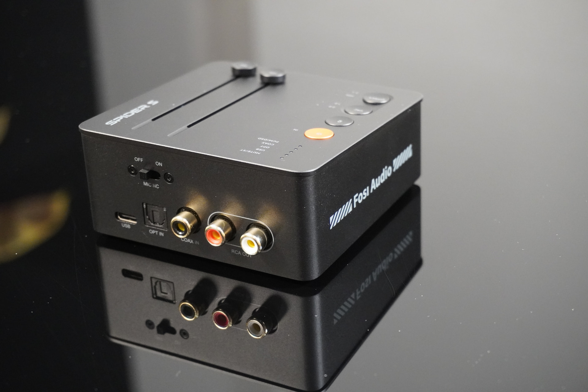

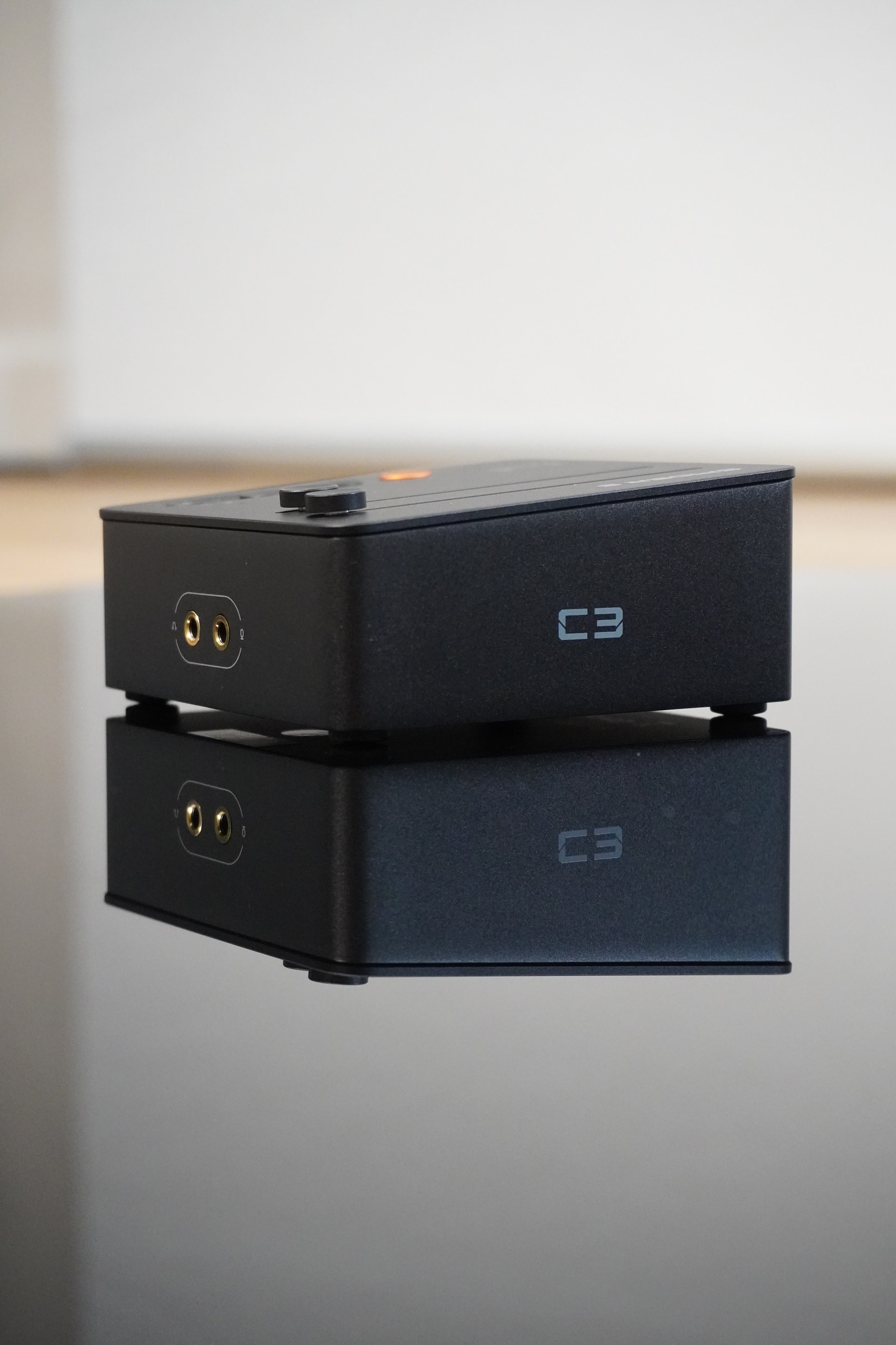

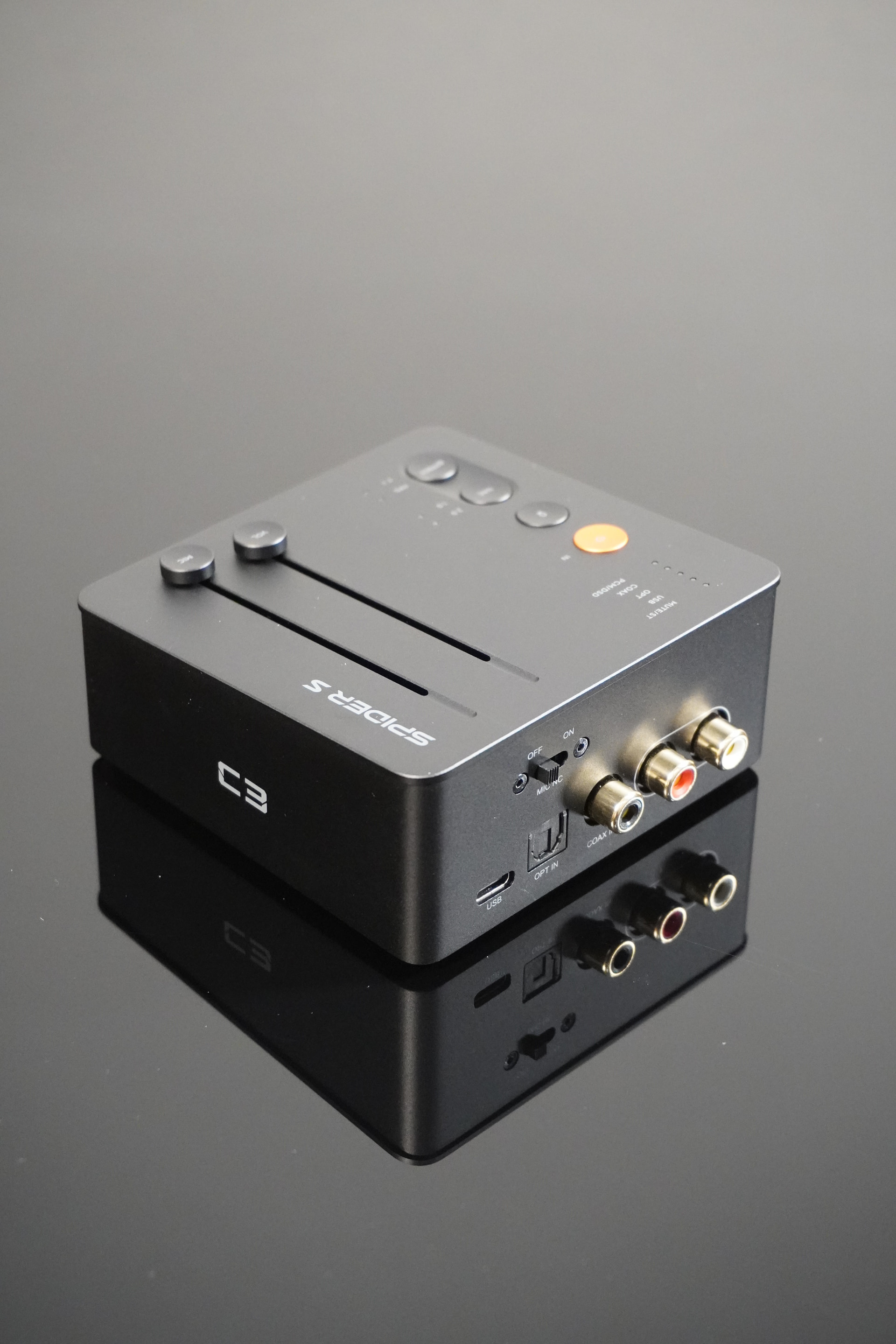

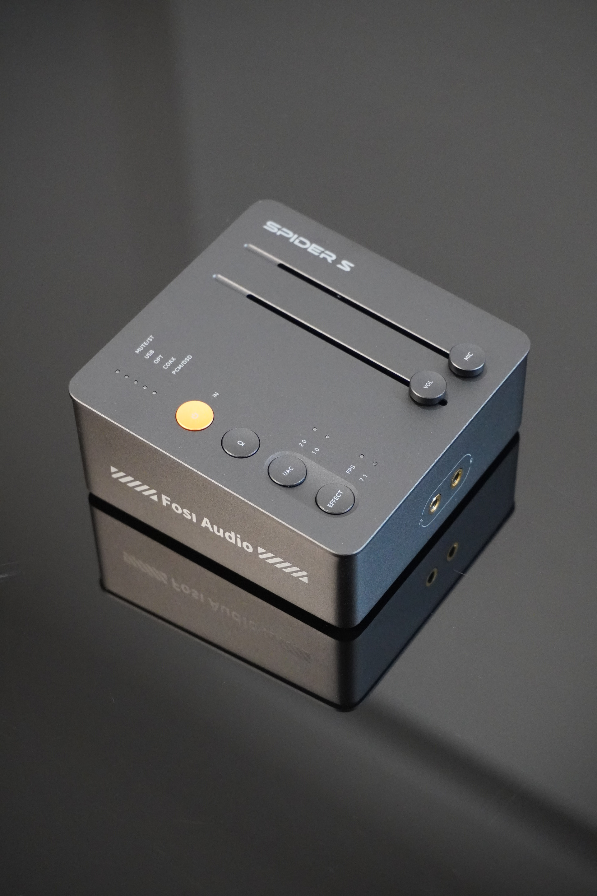

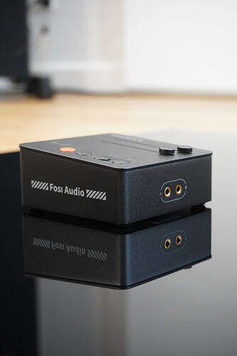

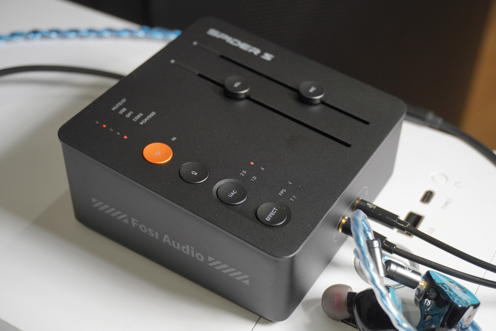

The C3 is built like a mini tank. All-metal case constructed from CNC aluminum alloy roughly the size of a square cup coaster. The control surface is an inclined 5-degree design that makes desktop access comfortable.

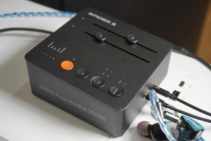

The interface relies on four physical face buttons and two vertical sliders on the right edge. These faders manage independent headphone volume and mic level, it slides smoothly and with a bit of satisfying resistance. Being able to adjust volumes mid-match by muscle memory is practical.
My first critique is the text printing. Fosi utilized tiny font markings and a low-contrast gray design that makes every button and status indicator a bit difficult to read.
Gaming in a dark room, I had a bit of trouble identifying what mode is active without leaning directly over the box or getting closer.
Input and Output

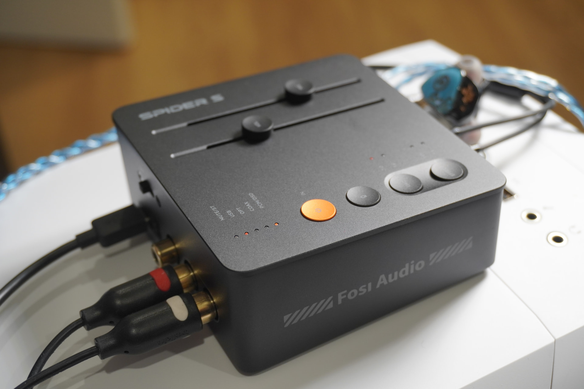

On the rear, there is a USB-C input (handling data and power entirely without an external power brick), an Optical input, a Coaxial input, and a pair of stereo RCA line outputs. The front carries standard 3.5mm jacks for both headphones and microphones.
Because the rear RCA outputs are volume-controlled directly by the top master slider, the C3 functions perfectly as a central desktop preamp for active speakers or an external speaker amp.

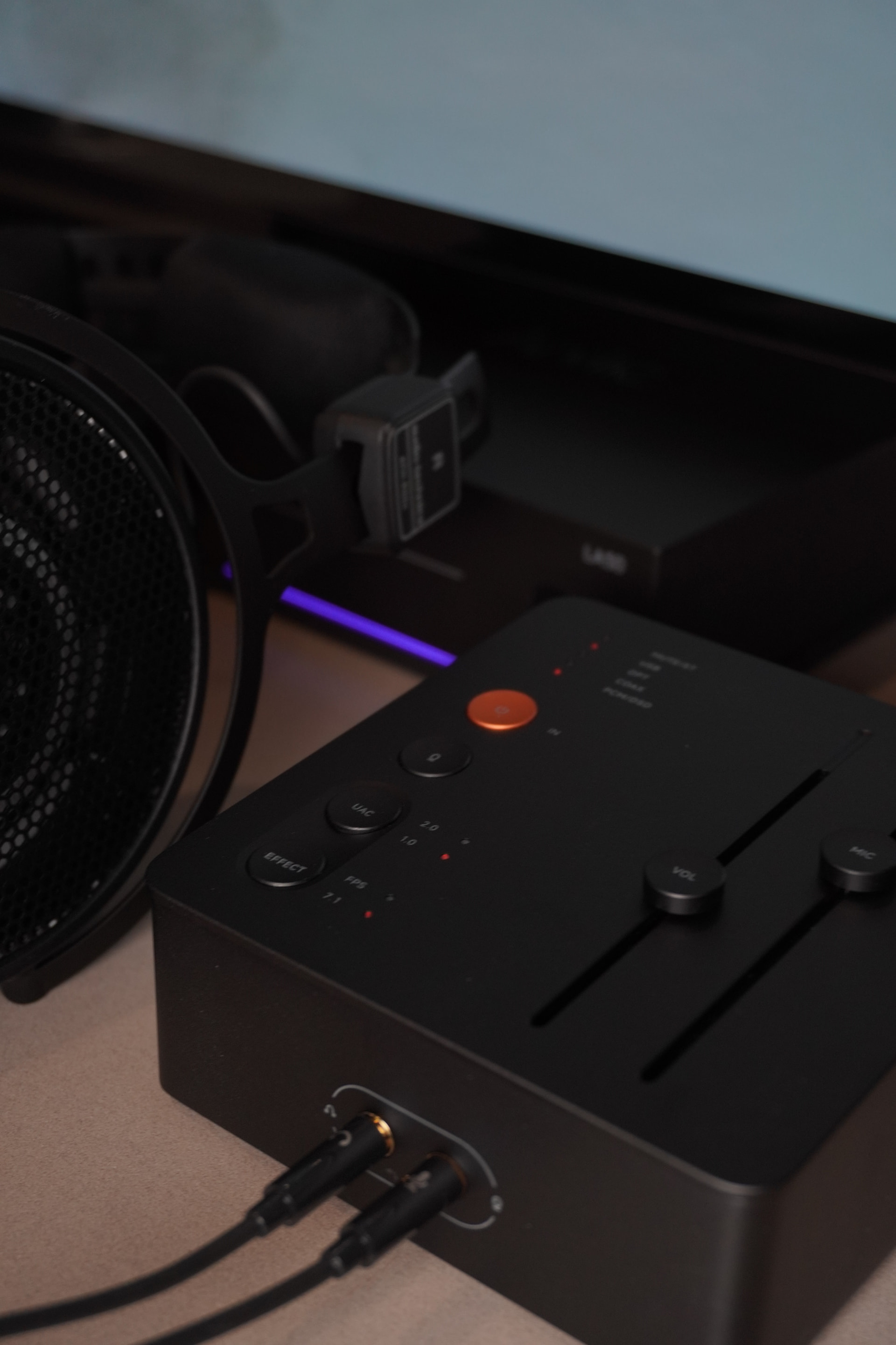

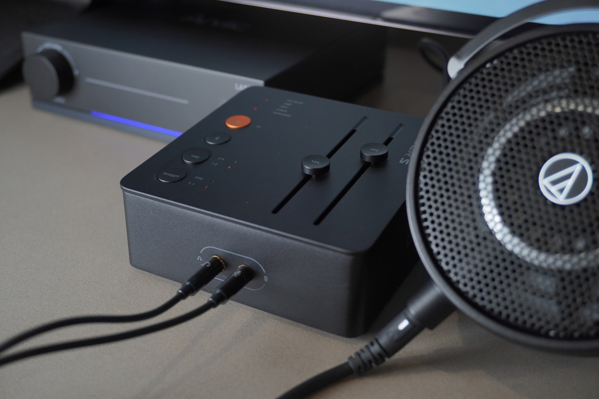

  • Audio-Technica ATH-R50x: The mid-range sounds crisp, airy, and beautifully layered. The spatial representation feels realistic and grounded. I rarely found myself pushing the physical volume slider past 45–50% to get a fully dynamic presentation.
  • Juzear x Z Reviews Defiant: The clean, uncolored nature of the CS43131 DAC acts as a fantastic counterweight to the Defiant’s thick low-end, keeping the deep sub-bass rumbles tight and fast so they don’t smear into the lower mid-range.
