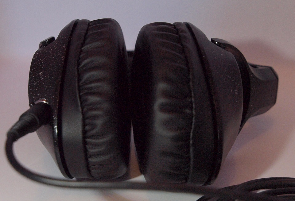

Ear pads:
  • As a replacement have been used pads for Sennheiser PXC550/MB660;
  • Unfortunately original fixing of these pads is not possible and new pads have been fixed with nano/gecko double sided tape (should be possible to remove pads without glue marks);
  • New pads do not fit precisely to the headphones, top left and top right side of plastic is outside of the pads couple millimeters;

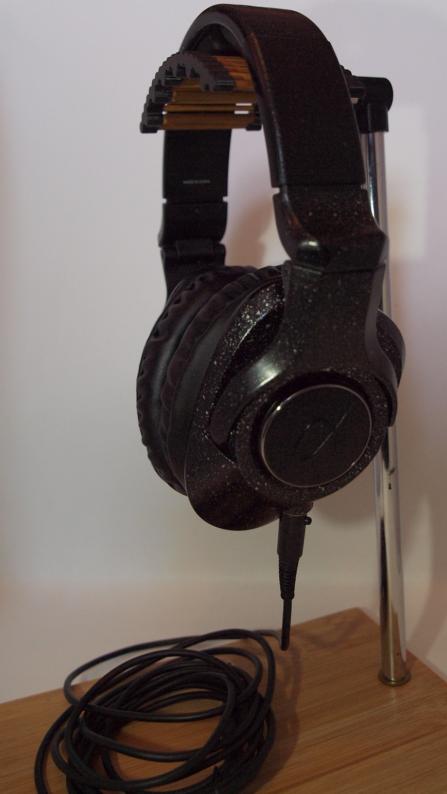

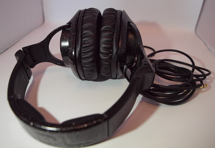

Head band pad:
  • As a replacement have been used two parts cut from pad designed for Steelseries Siberia 800/840/X800/P800/WirelessH;
  • Width of new pads is similar to the original one, but total length of both is shorter, in the middle stays free space (might be cover with black tape for masking);

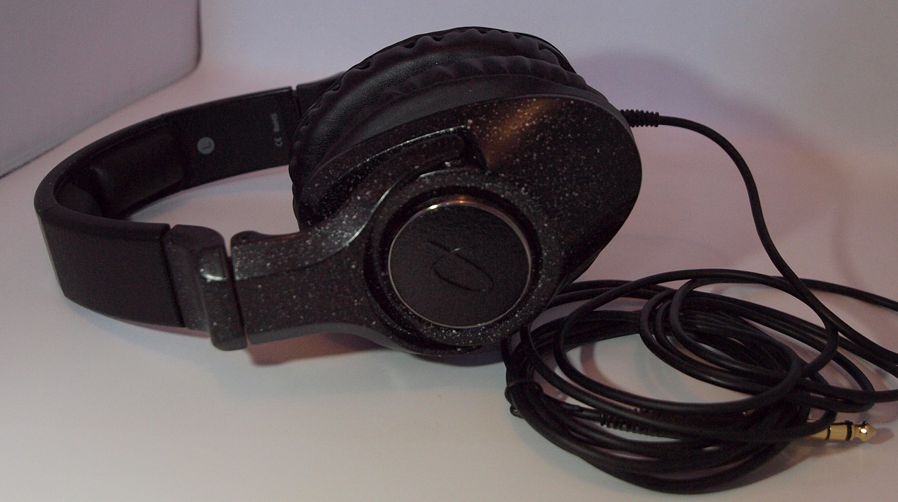

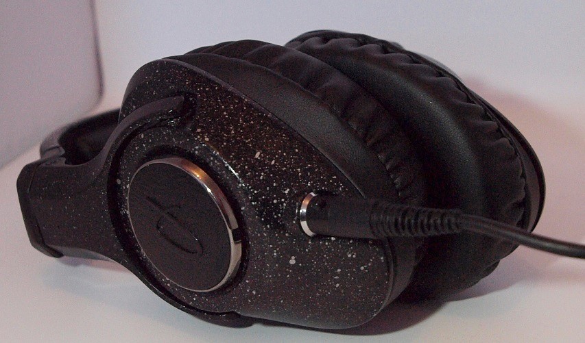

Refurbishing:
Most of plastics have been polished with sandpaper and paint glossy black. Then has been applied effect splatter with silver dots and clear gloss paint at the end. Plastics with texture on the surface have painted only glossy black.
Short update regarding ADL H118 pads replacement.
Universal ear pads size 100x85 mm fits without any extra effort and fix without any tape or glue.
