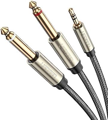

So, a friend got the motu M2 2x2 to allow him to switch between 2 sources (his mac mini and pc) while only using 1 headphone.
From his mac mini he is running a 1/8in TRS to 1/4in TS splitter cable, with the TS ends in the L and R mic/line/guitar combination ports on the front of the m2.
However, he is getting a lot of static from this, even when the mac mini source is powered off.
Here is one of two cable he’s tried:
What could be the issue?

That noise he’s most likely getting is a ground loop which is common when you connect things like this, but you really shouldn’t be doing it this way in the first place with the motu m2 if I’m understanding the situation correctly

It also should be mentioned that he used a stereo cable from the mac mini into one of the analog inputs and it worked fine with no static, but then it needed to be in mono mode.
