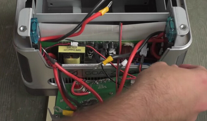

There is a lot of everything in there.
Source

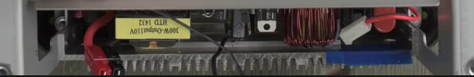

The open question is how it’s generating the AC and the higher voltages.
The fact it says “Pure Sine Wave” on the front probably means it’s reasonably clean power.
