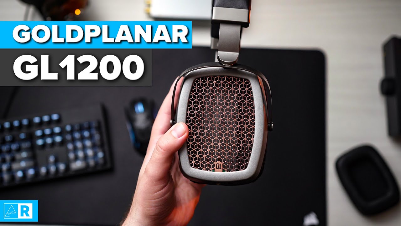

Here are some pics of the components that come in the boxes.
Couldnāt get a good picture of the headphone cable, it was too dark against the table to get any detail. But itās a decent balanced cable with 8 individual conductors. Easily a $50-60 cable.
              Iām bypassing the interface box for now and using the Jotunheim R (baffle compensation off) to power these headphones. I am using this adapter to connect the two. (Edit: A custom adapter is required to use with the GL1200) Iāll be trying out the interface box with some (relatively crappy) amps my friend and I have this weekend.
Getting into the sound right out of the box: this thing is weird in great and strange ways. First off, the imaging is crazy. Not sure if itās realistic, but itās very interesting. Centered vocals sound VERY intimate and pinpointed to the center of my head. While at the same time, instruments and stereo effects sound super three dimensional. In some tracks, sound is clearly coming from above my head instead of from the sides like all the other headphones I own would normally do.
Iām going to hold off on diving into the sound signature until Iāve broken these in much more. Only an hour in and I can already tell the bass is still coming into its own. I will say though, that I did a frequency sweep and found what sounds like major channel imbalance around 8.5 and 11.5 kHz. However, shifting the headphones on my head changed the channel balance of the sound at these frequencies. It seems as if different parts of the ribbons emit some frequencies at different levels.
