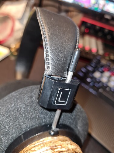

Anyone else get this cheap plastic knockof leather headband with theirs.
Researching these I only seen lether but mine came with this.
Are in the UK? I remember someone on head-fi got the same kind of headband due to some sort of ā€œveganā€ regulation or marketing push in the UK.
That’s the headband that comes with the lower prestige series like the SR80e and those.
Thank you, just got kind of worried that a amazon seller would have ript me of. Kind of stupid IMO.
Don’t feel stupid. They used pictures of the nicer leather headband and barley mentioned the difference according to what I read. I love Grado, but they literally don’t have a marketing budget and it shows sometimes.
