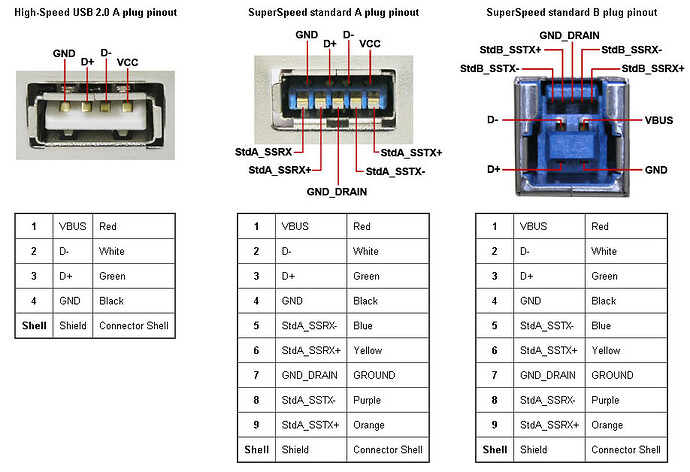

You are sending audio over USB, correct?
So what do you need 5Gbit/s for?
I think I have 3 SSDs (two of which are just boot drives) that could saturate that.
Yes, but not over the pins added by USB 3.0 Type-B
it’s also powering the Zen DAC.
Some devices need it for power. The extra 400mA makes a significant difference when there’s no external power supply.
then why use the more expensive SuperSpeed Type B if there was no benefit to it?
I don’t know if this is correct but I think the devices need to do a handshake to confirm it is USB3.0 and needs the 900mA otherwise it just sends 500mA to ensure backwards compatibility.
Well you kinda mentioned after this post but if the device in guestion does not support / need more power.
You cannot “force feed” it with more power even if the USB-cable would support more. :slight_smile: (well technically you can force feed any device with more power but it will probably burn after that)
It’s in the hardware limitation/restriction how much power it can handle or take in.

I may be misreading the USB PD-spec, AFAIK negotiation has nothing to do with data lines.
sure wish iFi had a support email…would love to ask why they chose SuperSpeed Type B over the regular Type B everyone else uses.
Not every dac is USB powered.
I know…but this one is…some of Schiit’s are and they use the standard type B printer connector. so incurring a higher production cost and customer’s end price makes no sense unless it has purpose…and reviewing specs and such, that purpose isn’t obvious.
