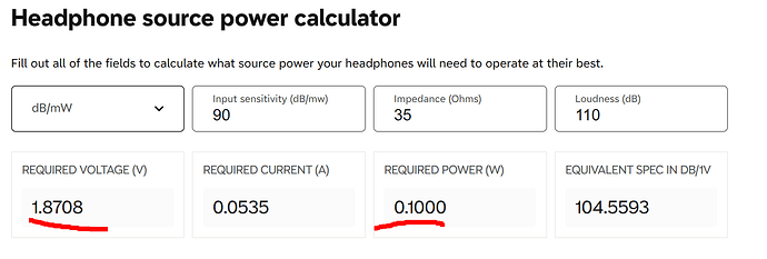

That Q7 has all the power you need to drive it.
Only 1.9vrms and 100mw needed for 90db averag volume with +20db headroom.
Have you put the Q7 in High or Ultra High gain in the menus?
