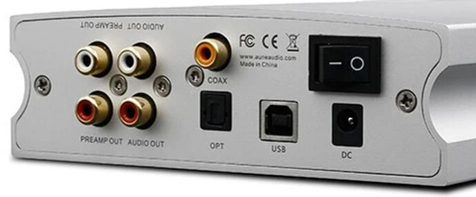

Do you need the preamp function on your X8?
I believe so…(still very new and this is my first setup)
I was planning to connect my thx 789 and my active speakers with rca
Also, while that switch looks great…that is far more inputs than I need
The preamp is only is only needed if you want to control the volume on your active speaker using the X8 knob. But that won’t help you with controlling the volume on the record player. Does your record player have volume control?
It does not have volume control, while my active speakers do
If your fine controlling the volume that way, then you don’t need to worry about the preamp output. You can just use the line out.
