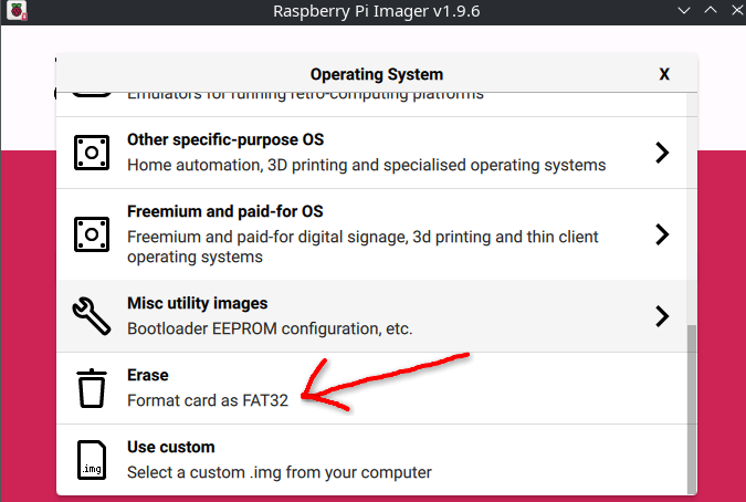

If you want a easy and stable way to format to fat32 (and flash images) i recommend the Raspberry Pi Imager.
https://www.raspberrypi.com/software/
