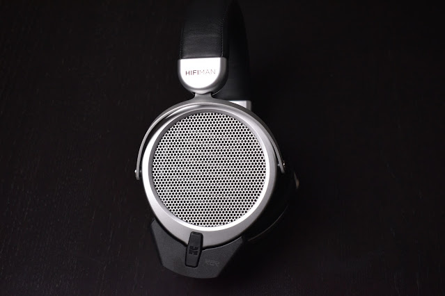

The aesthetics of the Deva Pro have changed quite a bit in comparison to the original Deva. The shape and style is still the same, however, the light brown tan leather pads and headband have been replaced with a more classical black look. I know there were lots of people who weren’t overly fond of the original colour scheme so I think that the more classical black and silver look will please them. Personally I liked the original Deva aesthetics but I also have no issue with the new look.
The build quality is much the same as any other Hifiman headphone of the same style. Using the headband that Hifiman chooses on the majority of their new models, there is plenty of adjustment in the cups, which should result comfortable for most people. I personally find that this style of headband does create a bit of a hotspot on the top of my head with extended use but for some reason, it doesn’t seem to be as uncomfortable (for me) over long periods as the Edition XS that I reviewed recently, possibly due to the cup shape and how the clamp to my face. Comfort wise I find it almost identical to the HE400se, which can still be improved with nuggets or the addition of a comfort strap, but is not a necessity.
Where the Deva does result far more comfortable (for me) than the HE400se is in the pad section. Where the pads on the HE400se have a kind of towelling material on the inside, the deva have a smoother material, similar to that found on the Ananda etc. Personally I much prefer this as I find the other material causes me to itch (and produces more heat).

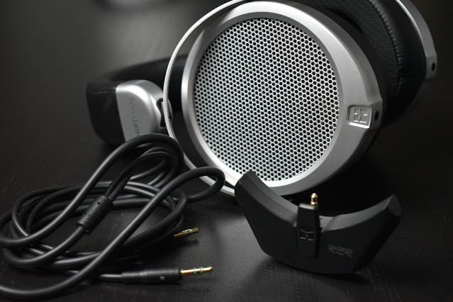

The connections used by Hifiman on the Deva Pro consist of a dual connection, one 3.5mm connector on each cup, however, the left cup also accepts a 3.5mm TRRS connector, which is how the Bluetooth module is connected. This is a system that allows the Deva Pro to be used with both the BT module and the normal cable that is included. It also opens the possibility of using other aftermarket cables of your choice. This is something that was a complaint from many with the Ananda BT, the fact that it could only be used via BT or USB, the Deva Pro solves this issue in a way that I find well thought out and implemented.
The Bluetooth module, which I will speak about more in the functionality section next, is made of plastic and is of a simple black colour. The shape is something that is hard to describe in words, so please look at the image, but it attaches to the bottom of the left cup and has the USB-C port, a single button and the microphone on the bottom.
In general I have no complaints with the Deva Pro build or aesthetics. It is not the most beautiful Hifiman headphone (that is reserved for the Susvara and HE1000se in my opinion) but I don’t see anything that I can really complain about in the price range.

The way the Deva Pro works is very simple. To use it in BT mode, you attach the BT module to the bottom of the left cup, hold the button to turn it on, connect to source and away you go. To use them with a normal cable set up, just remove the module and connect the cable to both cups. I believe you can also use a 3.5 TRRS cable to just one side if you prefer, although I am not sure about the pin out, that would need to be confirmed.
As I mentioned above, the bottom of the module houses the microphone, a status LED, the USB-C port and a single button.
To connect to the source for the first time, you switch on the module (hold the button for a couple of seconds) and once it is on, press the button twice to enter pairing mode. Once it has been paired with your device, the reconnection is instant when switching the module on. One thing I did notice is that the voice that informs you that you are powered on and/or connected is at the same volume independent of your source volume or previous listening levels. The voice is a little loud for my personal tastes but this is a bit of nit picking, it’s not like she actually screams at you.
Once on and connected, the button controls play/pause by a single press, to answer/end a call it is also one press of the button, with two presses to reject a call. Unfortunately this is all the control you get from the module. There is no way to skip tracks or control volume. This is not the end of the world but personally I like to be able to control volume on BT devices as the whole point of wireless is freedom from the source, so removing your phone (for example) from your pocket to change volume or track sort of defeats the object in my opinion.
The BT module features the Hymalaya R2R DAC inside, which is supposed to offer high sampling rates with low energy consumption. The module does support LDAC, along with aptxHD and aptX, so I have no complaints as far as connectivity. LDAC is smooth and doesn’t seem to have any issues staying connected, allowing me to freely roam my office while my phone is on my desk. There are also no issues with the source being in a pocket, so no complaints from me either.
