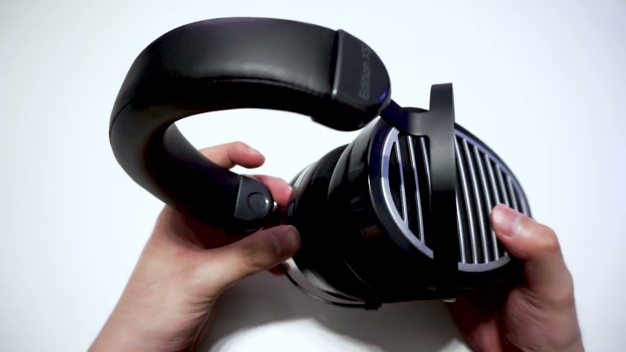

Ergonomics:
The Edition XS has a very loose clamp depending on the size of your head. I’ve found it’s fine when sitting upright, but laying back on a bed or couch the cups slide backward out of position. I’m not sure how much flex the headband will take, so I’m unsure how much this can be remedied by brute force. That said, it is comfortable to wear sitting, and the low clamp force probably helps some complaints with jaw pain that can be found in the similar Arya and Ananda headphones. Since you’ve handled the 1990 I can skip describing that - I had no issues with it in any position.

I bent the metal bits, and that helped a lot with the clamp force. It was much too loose for me stock, it’s much better now. You do need to be somewhat careful, aluminium can snap particularly if you bend it back and forth. So I’d try to get it right the first time.
