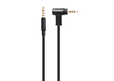

Searched a while for a pre made cable, best I found is this.
Edit: just found out that the balanced Argon has the same pin out (TRRS L+ R+ L- R-) so the periapt cable would work. Unfortunately the Argon uses a 90 degree connector. Guess you could order a cable with a straight plug though. (oh, @ShaneD already mentioned it.)

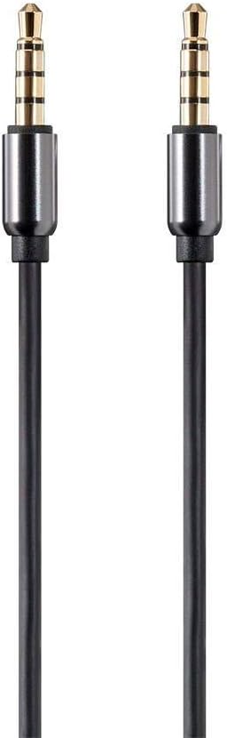

Think the message was when you want single ended you use the stock cable. Didn’t hear a mention that you could use any 3.5mm to 3.5mm TRS cable, like with the Fidelio X2. Means a mod mic will also work on these.
Edit 3: Budget solution for a balanced connection (not dual entry) you could use this adapter and any generic 3.5mm to 3.5mm TRRS cable.

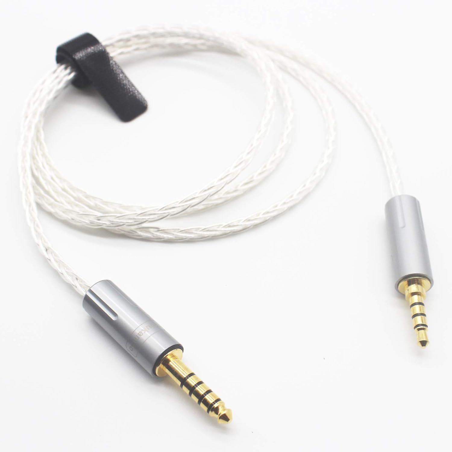

Edit 4: Ah, now where I remembered that the Sony 1am2 uses the same system it’s much easier to find balanced cables.
https://www.amazon.com/dp/B01M59HJXH/ref=cm_sw_r_awdo_0CKBE56EQVNRZD6D1SY0
https://a.aliexpress.com/_vaa6gL
