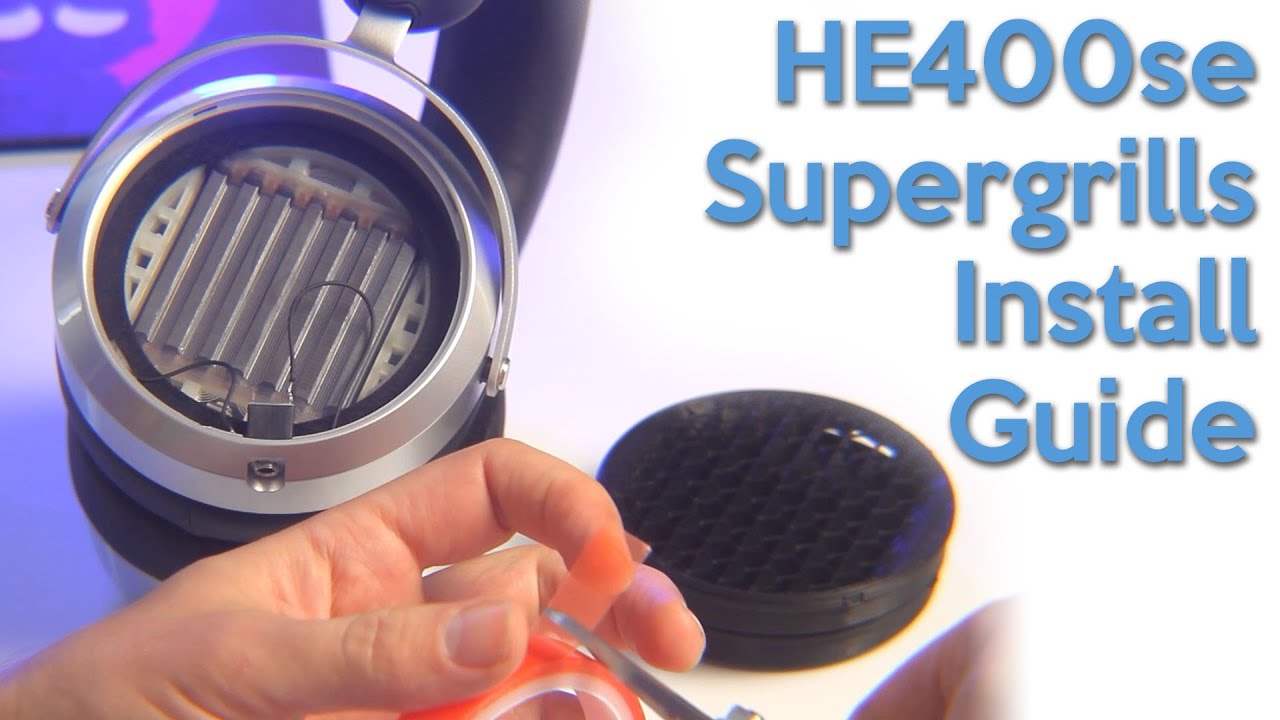

New 3D printed grilles by uk custom cans:
https://jfunk.org/wpc/product-category/home/headphones/hifiman-headphones/
I donât own the HE400SEs, but I do own quite a few other round cup models so Iâm gonna snag a couple pairs to experiment with. It looks like theyâre basically trying to accomplish the fuzzor, waveguide, and grill mods with a single installable piece. I, personally, havenât found the waveguides to make any noticeable difference on the two models I tried it on (HE6 and HE400i), but itâll be interesting to see what the cumulative effect of all this is.
