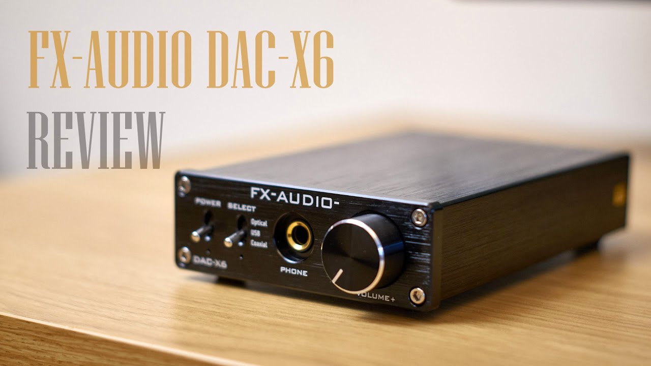

Now, that said, if your budget is $75 with no flexibility at all and you don’t need a mic input, I would recommend the FX DAC-X6. $65 in Amazon or Aliexpress, plenty of power and a noticeable improvement over onboard IMO. Drive my cans for 8 or 9 months and I have no complaints about it. For $80 there is an MKII with apparently a better DAC solution and Bluetooth.

I believe all you current headphones aren’t that demanding, so even if they can scale and benefit from an amp, my recommendation would be to save up a little more and go for one of the options suggested here. If I’m wrong and one of your headphones is struggling with your current output, then I still recommend the DAC-X6 as a stopgap.

The Fx Audio Dac is technically old.
If you use it without Audirvana it will work fine on your computer and Audirvana is not necessary in this case.
Because it does not support DSD conversion.
The Ify, on the other hand, could be run without Audirvana for the time being and the software could still be purchased later.
But the Ify would make more sense, it has more power and is technically more advanced.
