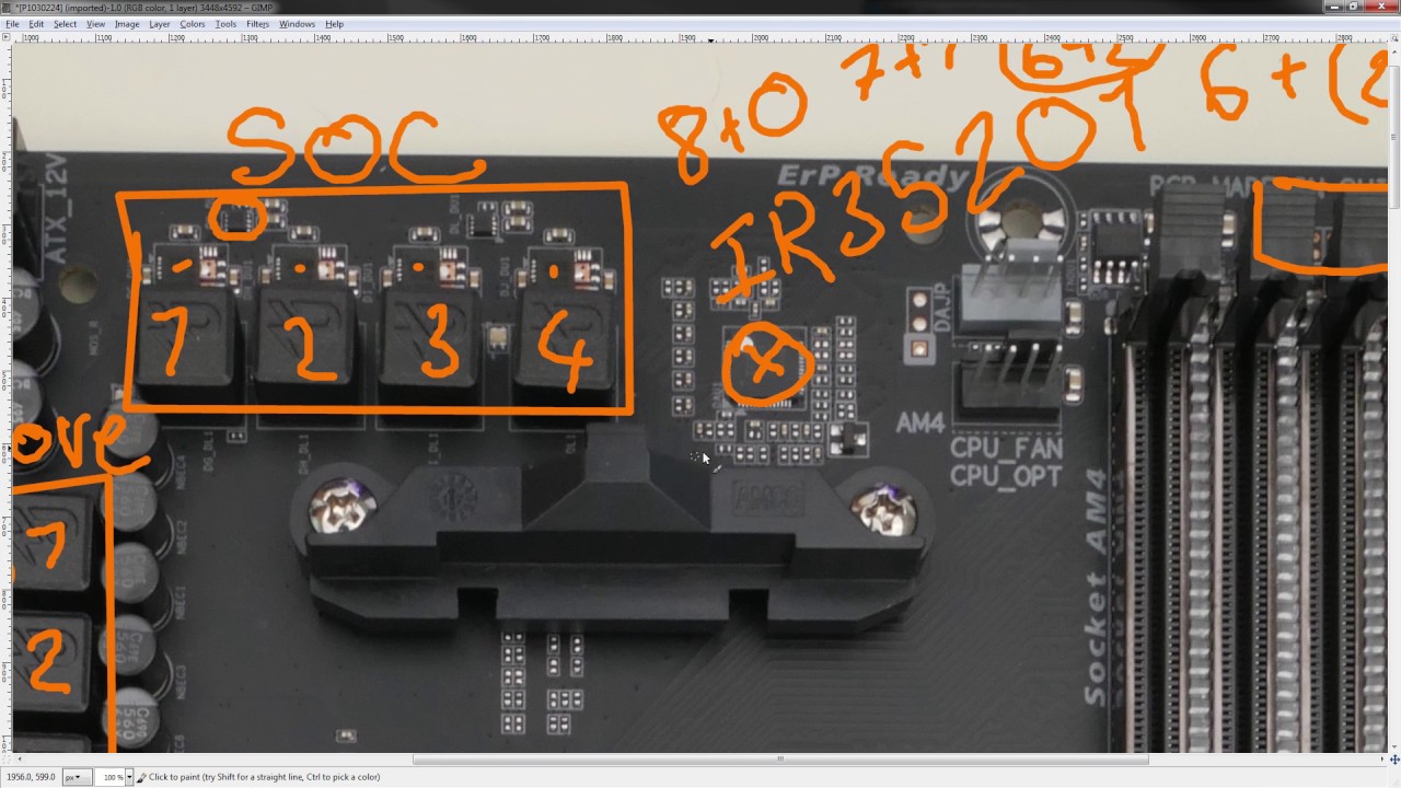

Super in-depth review on the Gaming K7 (warning: requires OCing or electronics knowledge to make sense):
Knew I recognized Buildzoid’s video
I remember watching Buildzoid’s video, thanks for reminding me it exists lol.
Tbh I was more worried about the whole power distribution to the CPU and it’s related components as I like to overclock the sh*t out of my stuff, and wanted to know if the power delivery was good enough to handle it. I’ll give it a look, see if he mentions anything about the shielding for the on board audio
He does not care about anything that does not increase clocks or stability.
Gigabyte sometimes has BIOS as bad as Asus, but their hardware on their high-end boards is at least 9/10 all the time.
