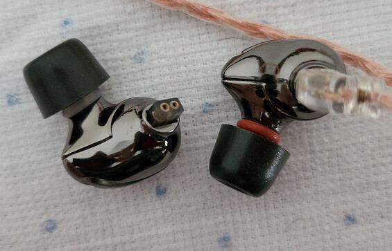

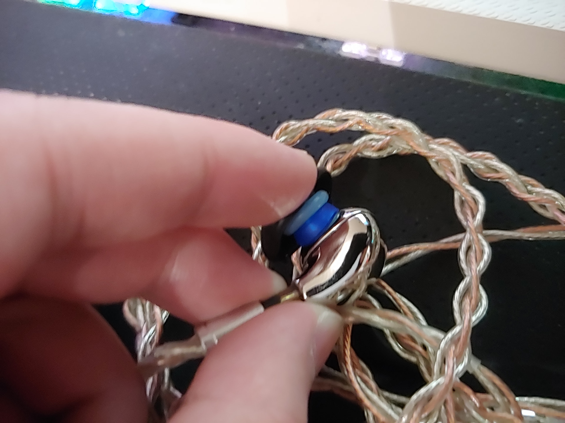

There is actually another trick you could use, put a silicone o-ring onto the tips/nozzle so it secures it more. This was popular with the blon bl-03 years ago.
https://www.head-fi.org/threads/blon-in-ear-monitors-impressions-thread.916702/page-328#post-16035453
(oh god i feel old now..thats my post 6 years ago.)
